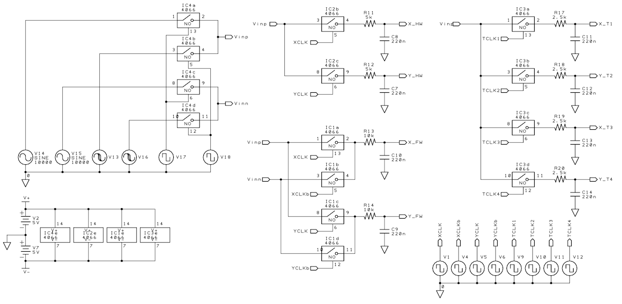

        Back to Tayloe mixers... I ran a sim comparing half-wave, full-wave, and Tayloe, the results were partly expected and partly surprising. Perhaps someone else would care to run such a sim, before I let the beans out of the bag.
        • #64
          Could be, I've done no more than a cursory glance.
          Can you post a picture of the schematic your using for the Tayloe or a reference? There are several variations in the document I posted earlier.
          I'd be interested in the schematics you're using to model the "synchronous detectors" also, just to try to compare apples to apples.
          -SB

                  Below is the test schematic. I'm running a 10kHz pure sine, but at 20ms I switch over (via IC4) to a SFFM source which provides a 2ms phase shift, up to about 45 degrees, then back to zero. This simulates a swept target. Various demod clocks are as described before.
                        Please have in mind that practical implementations of Tayloe go without additional resistance in series with switches. It exists though, and it is in effect attributed by source resistance plus Ron of the switches. That's why Tayloe mixer works fine in spite of the not-so-symmetrical impedance of differential amplifiers that follow the capacitors.
                            The same circuit methods used in the Tayloe mixer can be used in the other demods; the only real differences are in the switch configuration and timing. Ergo, I used a simple RC load on all methods to give an apples-apples comparison.
                            • #74
                              True. However, in Tayloe you do not require additional resistors because there is no overlapping ON periods that need to be isolated. That's where you slightly deviate from apples and see some extra fruits
                              • #75
                                There are no overlapping ON periods in the other two, either.
