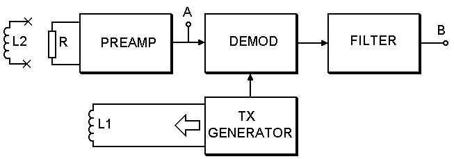

                    Monolith, please make an experiment.
                    Connect a resistor R instead RX coil as shown below. Then see with oscope the point A (output of preamp) and the point B (output of filter after SD - synchronous demodulator). After filtration of demodulated signal, there are only 1/f noise. The SD can not see the Johnson noise. However you can not see also Johson noise in output of preamp, because its gain is limited by large AIR & GND signal in input.
                          Hi Mikebg,
                          thanks for the answer.
                          We filter and filter and filter, but in the end the low frequency noise is still there, because this is the frequency that the pure target signal is. But let me take advantage to ask the professor about the Johnson noise. I had the understanding that this is of very wide spectrum and includes the 1/f noise. Could you dispel my doubts and explain in more detail?
                          For very small targets I need up to 300kHz bandwidth in the preamp. For large targets, 50kHz is good enough. I use IB, by the way.
                          But where does the sweep speed come in? with perfect Ground Balance the detector only "sees" the difference between the Ground and the Target and this difference happens during the time the coil sweeps over the target.
