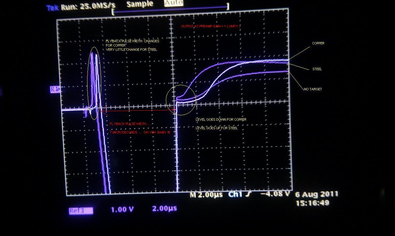

              This is a very good discussion and I was down the beach when I saw it on the phone ... so on the way home I thought about Monoliths kind words regarding the differential coil .... there is no reason the technique I am using should not work on a "real" monocoil. So into the workshop grab one of my early monocoils ... connect to the UNIPI chip breadboard and "unbelievably" ... I had to check it twice ... the same technique works with monocoils.
              I have posted the result below .... I can get rid of / attenuate the AIR signal. I cant get rid of the flyback ... that is a physical property of the coil and the sudden cessation of current at turnoff.
              I think it was Mikebg who mentioned that the signal to noise was awful on the monocoil because it is masked under the AIR signal.
              Well .... ( Aziz ... are you paying attention ) ... not only is the signal to noise on a monocoil quite good when the AIR signal is removed but you also get the excellent descrimination signal as well.
              Not only that but to proove a point ..... I set the gain of this preamp to 1 ( unity ) . OK the targets are large ( 4 inch square copper & 4 inch steel ) but not only is there bags of signal but also bags of descrimination signal as well. ( 1 volt without amplification !!! )
              The coil I am using is nothing special ... the fastest sample time I could ever get on it was 18 microseconds on a conventional PI front end. You can see how fast it is now
              When this gets out ..... I think a new era in MD technology will start.
              cheers from moodz.

                ... point of clarification.
                In the previous picture where I note the pulse width change the spikes are not the fly back pulse ... the whole pulse is the flyback pulse.
                ....and Aziz ... watch out ... when I done with the monocoil I am going to give the IB a work over as well.
                moodz.

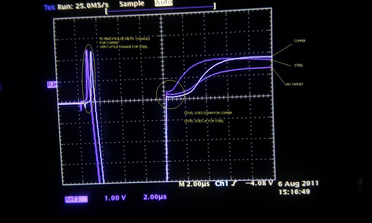

                    update ... clarification.
                    A new pic just to make sure that its clear that the monocoil gets the following benefits from this technique in addition to benefits I already listed ....
                    6. No false descrimination ( thanks Mikebg )
                    7. Faster sampling due to removal of AIR signal
                    8. Descrimination ...
                    9. Big improvment in signal to noise
                    .... and since I had a celebratory vino .... Aziz ... you can use your IB coils as pizza trays now ... LOL ..... ( no offence intended )
                    Please accept that as a challenge not an insult ...
                    moodz (half pi$$ed )

                      Aziz .. observe the clean transition from flyback falling edge to target signal .... ( in the centre of the pic ) .. these preamps I am using have huge bandwidth at unity gain and beautiful recovery .. this one is better than 13 Mhz. The Mosfet is not breaking down and the technique counteracts the parasitic capacitance ... that is why there is no ringing ... think opposite of resonance ( anti-resonance ??? )
                      Inductive circuits have a "Q" factor ... I have discover how to apply negative "Q". Thus emliminating the tendancy of the circuit to "ring" or oscillate. It is so beautiful I am going to have another drink ....
                      Hic.
                      moodz.

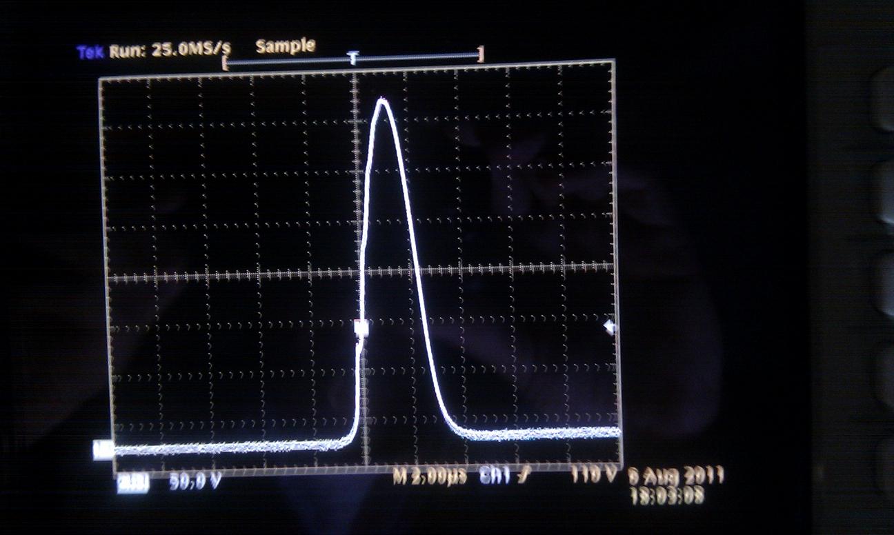

                        Hi Moodz,
                        look at the peak flyback voltage!!!
                        Aziz
                          Hi Moodz,
                          Aziz
                          OK already ... I have to turn the CRO on ....
                          moodz
                            ... the picture is a bit blurry.
                            ... so is my eyesight after this vino
                            50 volts / div vertical
                            2 us / div horizontal
                            about 400 volts peak ??
                            The MOSFET breakdown is 500 volts ( probably 550 in reality )
                            The coil is 16 turns 18 inch diameter.
                            moodz

                                Moodz,
                                you didn't understand me.
                                Make the measurement for no target, copper and iron. And look at the peak flyback voltage. If you can zoom around the peak voltage, the better we could see the difference.
                                Cheers,
                                Aziz
