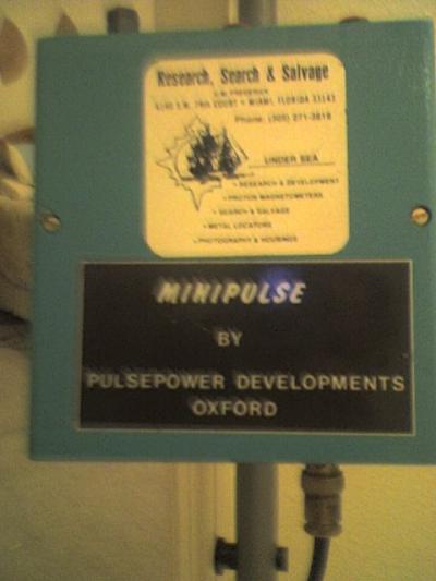

                      Is this the detector?
                        Yes thats the detector that I am working on. Is yours operational?
                          I've so far not found any details on it. But products starting with 295- all seem to be transistors, not IC's. You could, if all else fails, remove the good device and determine it's basic characteristics and fit a general-purpose replacement to see if the detector has basic functionality.
                            Thanks for you help Skippy, I'll give that a try.
                              No that is not my machine just a photo of the one you stated.
