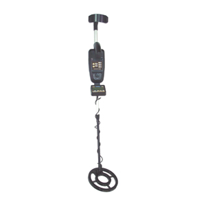

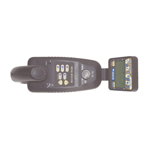

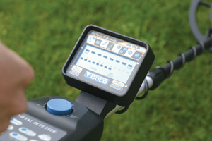

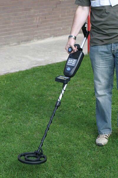

    I was looking around and found a .pdf of several Maplin MD designs and their capabilities, see attachments for a copy.
    What interested me was the given performance of the "top of the range version", or L24BK as it is known.
    Firstly its very, very cheap compared to its spec, a 10p coin being quite small at 25cm!!! I don't have a 10p to hand, but probably its well less than 2cm across, quite thin and made of a silvery (Nickel?) metal.
    Has anyone here used a L24BK? Bought one? Heard anything either positive or negative? It looks quite reasonable from the comparison chart performance wise.....LCD display, 8 metal modes etc etc etc....
    You can see it here:-
    http://www.maplin.co.uk/professional...detector-47168
    It costs only £89.99.......maybe about €100 (around US$160) at todays exchange rate (I did not check though!!).
    I have added some pictures and the comparison .pdf document that lists the features of all the various Maplin MDs. I was looking mainly at the top version
    Thanks for your time.
    Andy

      it is the GC 1010 same producer as from the GC 1023 (black bull, black knight magpie)
      it is from china my father has the GC1010 the search distance is around 25cm for 1 euro coin with all metal mode and no disc with disc it are 23cm
      you cant drive in full sens it gives a lot of false signal in wet ground it hates forest ground
      the disc make no difference between alu and gold no i dont found gold but it shows gold when i found alu

              I have read good things (on another forum) about the junior model in the Maplin range, the L45BH, as in - it's quite adequate for the price of 30 pounds, and does actually detect things. It would be reckless to assume the more expensive machine was also OK, though.
              The potential problem with these badge-engineered Chinese detectors is lack of consistency - one might be OK, the next poor.
              The British 10p coin is 25mm diameter, medium thickness, and made of cupro-nickel.The quoted depth figures would, I imagine, be air-tests, how well the machine works in ground is a different matter.
              A better use of you money would be to buy a secondhand branded machine, commonly suggested models include Garrett's ACE150/250, Fisher's F2, and many more.

                Hi bernte_one. 25cm for 1 euro in the air and not in the soil is not it? The soil will be barely 15cm...
                  Andy,
                  Generally you get what you pay for with these Chinese detectors. I haven't tested this particular model, but the Chinese detectors I have tested had sub-par performance and very poor build quality. A consistent problem I've seen is a horrible lag in the audio response, which will drive you crazy trying to pinpoint. Also, forget about accessory loops.

                    I think the model shown in post #1 is GC-1019
                    http://www.globalsources.com/gsol/I/...1001865318.htm

                          I have something similar, (The LCD is the same but the case is more like ACE150).
                          It runs on 2 x 9V. I have moded it for set AA batteries, and made more gain in ops.
                          It worked well between copper rock hills selecting iron pieces under the rocks.
                          The oscilator frequency is to run micro. The coil runs on 6.5 kHz.
                          I may have schematic for it if some one make pics of PCB to check components.
                          The coil oscilator is a hart of detector and is not synch. with micro clock so the frequency can by change a litle for better coils. My unit needed to reset power periodicly to be stable. Buy one used for nothing and play with electronic and coils - good fun.
                          I have check range for two units like that and it was just more than 20cm for 25c US. in air.
                            Gentlemen, many thanks for the comments and help, I don't think that I will put any money into one......
