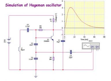

    It is absolutely incopetent to design operating point of such amplifier near to transistor saturation, because the gain is minimall and (if oscillation starts) the circuit can not deliver enough amplitude. ...........................
    Note that there is no information how to design the operating point of transistor for reliable start of oscillation and for large amplitude (because the author is not radio amateur :-).

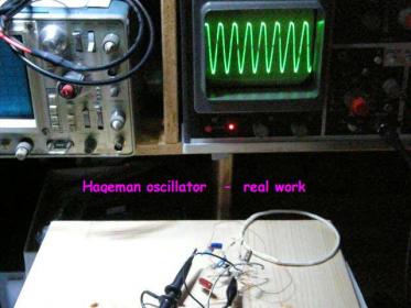

    Despite of what "competent radio" AMATEUR PHILOSOPHERS says, Hageman (a little modified Clapp - not Colpitts!) oscillator works very well.
    Maybe not in world of lost in space simulations, but in real world it works (oscillate) with appropriate, clear and stable signal, as shown on pictures:
      Despite of what competent "radio" AMATEUR PHILOSOPHERS says, Hageman (a little modified Clapp - not Colpitts) oscillator works very well.
      Nothing new! The authors insist that the circuit works wery well:

          What amplitude of oscillation shows your experiment with Clapp oscillator?
            As competent radio amateur you have to know that this is not Colpitts but Clapp, no matter what author say.
            To be pedantic ... the author is not totally incorrect, as the Clapp oscillator is a member of the Colpitts family. You can see this in the circuit diagram, as the feedback voltage is derived from a capacitor network, unlike a Hartley oscillator where the feedback voltage is derived from an inductor network.
              What amplitude of oscillation shows your experiment?
              Genau 500mV pp measured at coupling capacitor (on mixer side). Without very small (2.2pF) coupling condenser I got emitter amplitude 2.6V pp (the same direct on coil).
              This is single oscillator operation, without mutual inductance with other oscillator.
              Maybe it seems a little low, but high signal amplitude is not general answer to better detecting. There are many factors that changes with voltage changing and not every with positive effect in detecting.

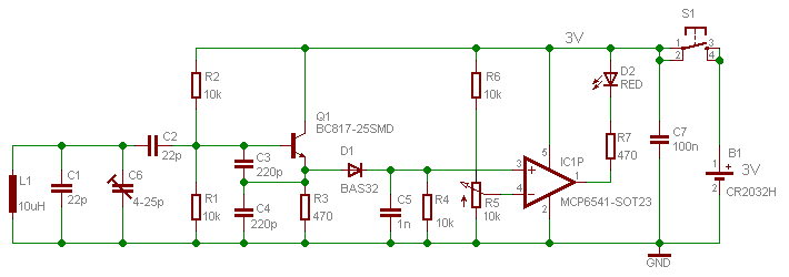

                  Here is circuit diagram of an absobtion metal detector. IMNHO the operating point of Clapp oscillator is competent designed. Source:
                  http://iloapp.marcboon.com/blog/rfid?Home&page=4
                    Great project of Marc Boon. Thanks for info mike.
                    Tuned at too high frequency to be suitable (in present schematic) for metal detecting / prospecting.

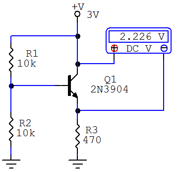

                      See the operating point:
