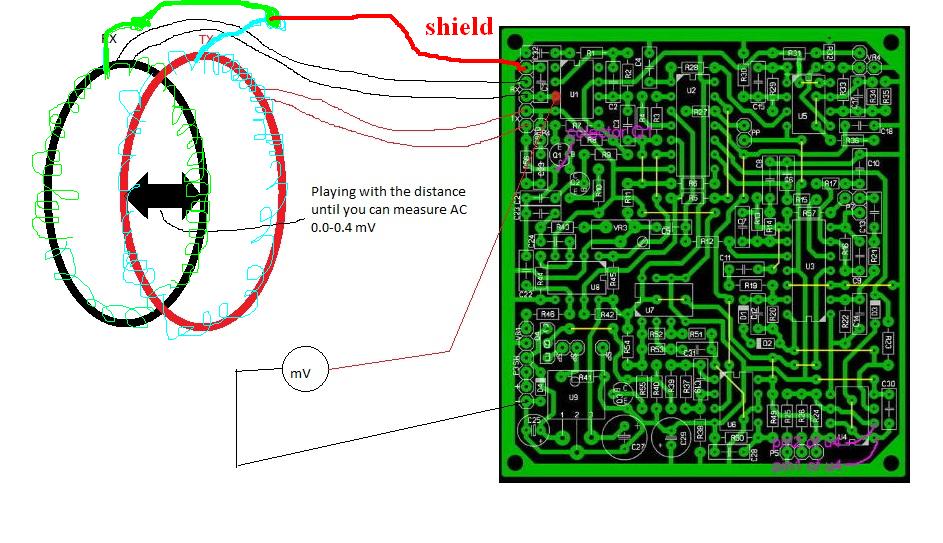

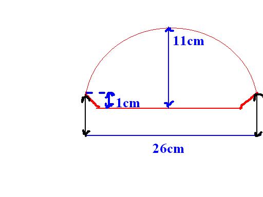

    • hi please say me this guru
      i want make DD coil and need help about Diameter and RADIUS of that.
      for the picture (thinks it is DD coils ) and say me of the wires
      many thanks

      • You can draw it on a paper and squeeze a coil into such shape by hands. Circumference is estimated by similarity to an ellipse, and there you have it. Unless you want to make a machine that produces coils to some strict dimensions, it is very OK to do it approximately.

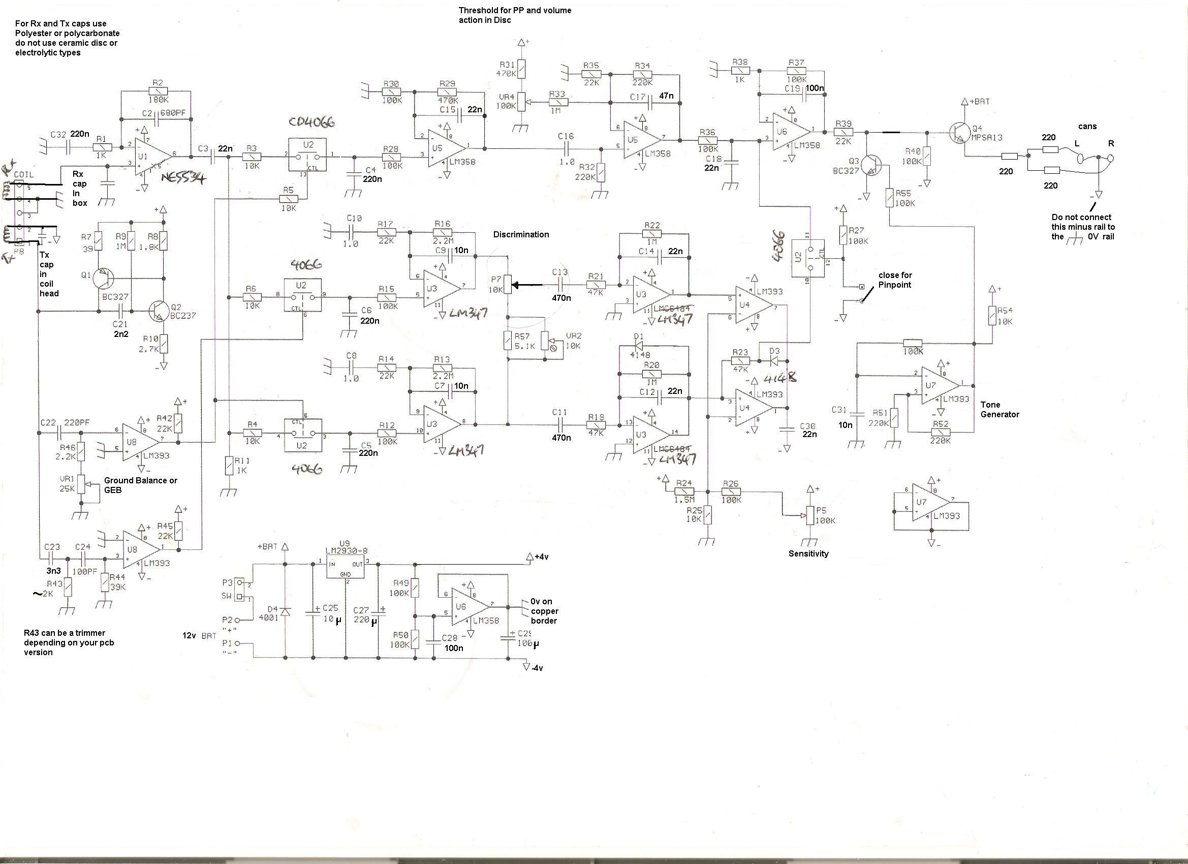

                              • I know some people have a mare making this unit.
                                Hope this drawing helps.
Name:	IDX Pro Cct.JPG
