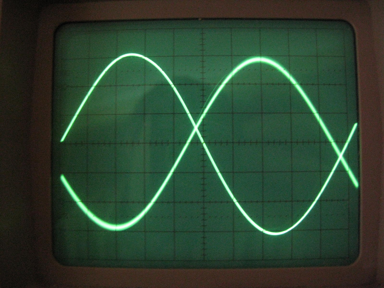

    • what is the idea for phase shift without any cap in rx i should hear one beep for copper metal target is that indication of initial good phase shift?
      when i put capacitors in parallel with rx coil i reach max voltage at 27 nf
      in this way it is resonance frequency match between rx and tx
      now reducing capacitor to 18 nf i get all needed reject frite iron every thing is ok
      if i try to go above 27nf i hear double beep :
      and when i sweep rx coil i get very good sensitivity but without ability to reject frite
      TX frequency is adjusted to 6.5k hertz using computer sound car scop software
      how can explain?
        I don't have any info for No Cap on Rx..
        I set up correctly all targets are single beep....
        Yes - I believe it is.... you cant use machine like this TOO Twichy
        This puts your Rx coil cap freq Above the Tx freq... Good initial phase!!
        With the large cap you are below the Tx freq - as per design - but initial phase is 180 out...
        You can use it like this, you just need to reverse Rx coil connections and should be good to go...
        This should improve when you do larger cap and RX coil reverse...
        You sound V close.. S

            try to tune rx below tx frequency without any success cannot reject frite rod
            but with 18 nf ( Rx frequency is above tx) i get 25-30 for coin air test
            • If you go for the big cap - so below Tx.... Do you get double beep. ... if Yes - then reverse Rx coil connections and retest.
              If you get single beep, and Rx is below Txas per design,. If you cant reject ferrite in this state then you would need to ...
              Re locate the Rx OR Tx coil in shell a lttle or try a cap value tweak of Tx or Rx..
              Really you would have done this work before potting your coil... ( Assuming you made it! )
              S
              • "cannot reject frite rod" How long is this..... 100mm???? You only require a length 20mm long.
                Do not pass it closer than 25mm. Use it like a coin at 3" - 4" ( ~10cm )
                S
                • it is 10 m long and 12 cm far
                  and yes it is home made dd coil
                  i will stop on 18nf on rx coil
                  it is just questions
                  thanks man
                  i use zlecop which is sound card pc scope to set tx to 6.5khz
                  dont know if it accurate software
                  • If you got scope ... Put L CH on TX and R CH on peamp out/..
                    When you get Rx sig phase like this it will work
                    good luck S
