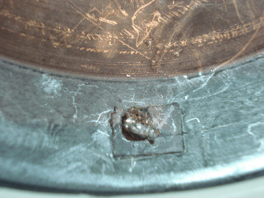

            • How do you connect your tap wire to the card. I have tried just tape and it works well but don't think long term reliability would be good. Also tried graphite mixed with PVA glue into something like toothpaste this is conductive but you can pull the wire straight off as it dries as a powder.
              • I watched all three videos, I learnt nothing. What was the point?
                Andy
                • Originally posted by Koala View Post
                  i used a small square of copper tape(4mm square), i stuck this on the card and soldered the fine tag wire to it, then i coated the card with graphite making sure i put a nice dollop on the soldered spot.
                  for the bottom piece of card i did the same thing added a small square and put a tag wire on it, if you find the right spot to place the tag you only need a small length of fine wire to join the two, the shield braid solders to this, the graphite i use is graphite powder mixed with clear acrylic lacquer, to sat dave uk's recipe, the only difference between his and my recipe is he uses polyurethane varnish, i am violently allergic to polyurethane paints so substituted acrylic lacquer.
                  i did try spray on graphite but i think its a- too expensive, b- too loose it needs a fixing agent, c- makes a bloody mess as it just comes back off.
                  with a nice coat the solvent soaks into the card (then dries) leaving a solid carbonised faraday shield which works very well for me.

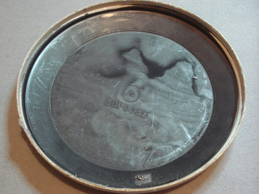

                  • Originally posted by sinclairuser View Post
                    Pictures of White's coil bottom part
