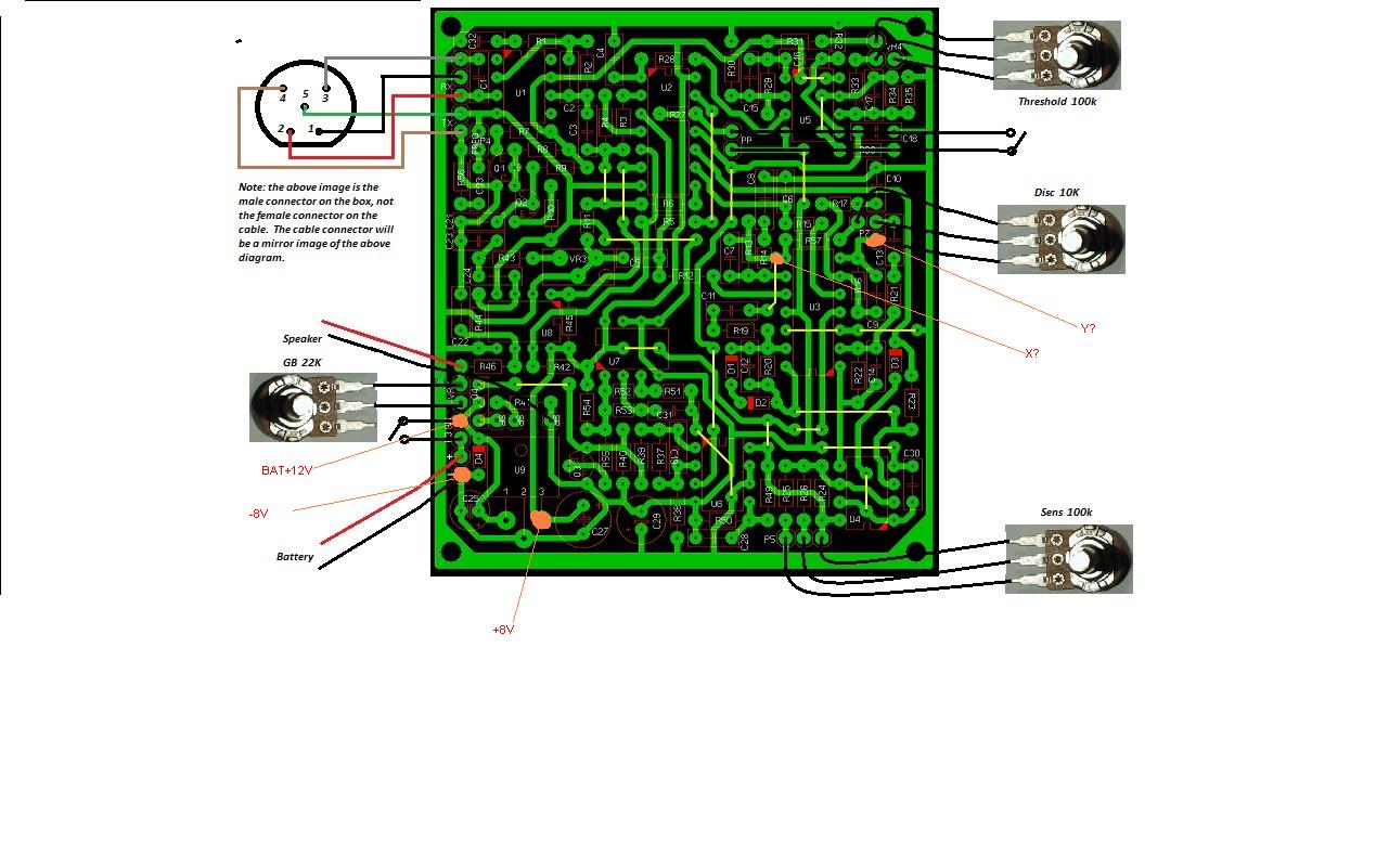

                            • ok i got my boards from silverdog they are great smaller than i was expecting so thats a bonus. just if anyone knows how the wiring for power goes if you could help a bit you would save me some time. it looks like there is a switch wired to the board but it says p5 also theres a pot in the front called p5 so iam wondering is that pot a 100k with a switch if it is i still cant tell how all the holes near the power works. i don't know if you have pass me a hint please.
                              • I have this;
Name:	IDX PRO quick connect_finalvdi.JPG
                                I think you could use a pot with a switch on it for Sens. Silverdog even
                                sells some (which I got for mine).
