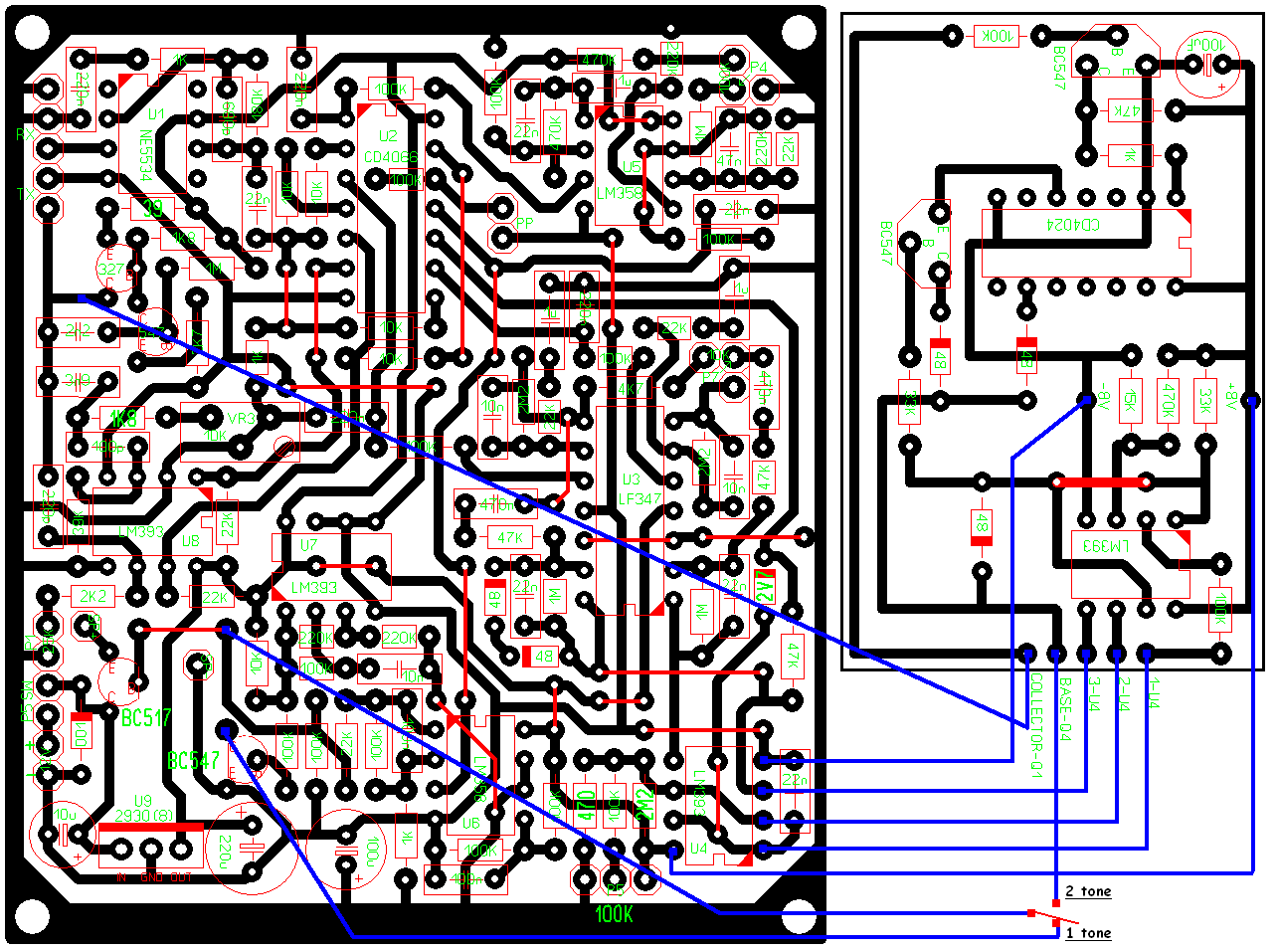

              • hi
                any body have VDI programing.(no hex file, master file)
                how it is work?
                about 2tone,any body can explain??
                  hi
                  how it is work?
                  This is connection for 2 tone. Click image for larger version
Name:	conection IDX - 2 tone.PNG
                  • Originally posted by CDI View Post
                    This is connection for 2 tone. [ATTACH]39490[/ATTACH]
                    thanx
                    but i need to explain about VDI schematic and how it is work.

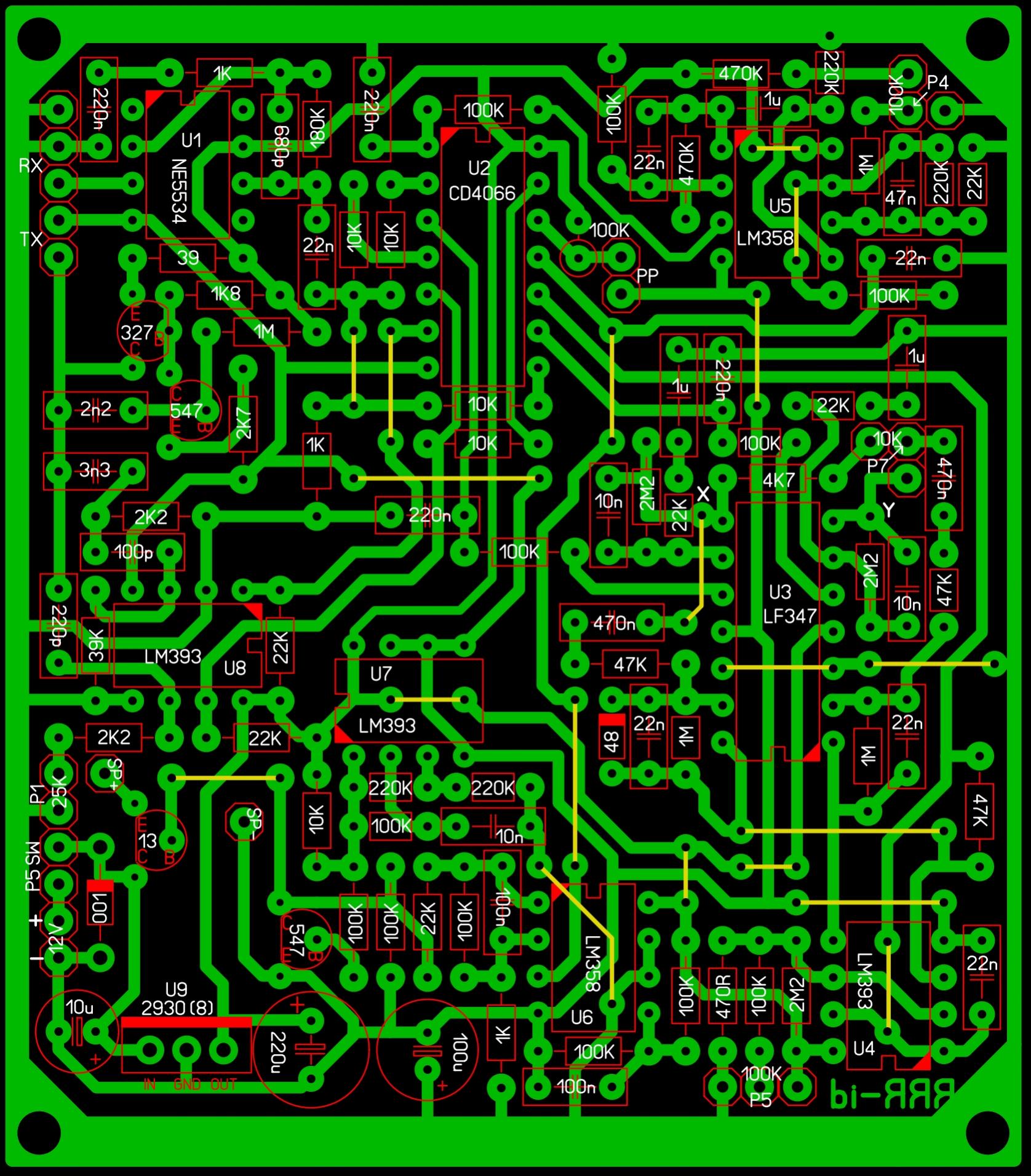

                        • Bruh, is this board layout from eduardo here, still worked without update? Im already put most of the components
                          After i browse, most of the pcb picture have 10k trimport and 3 zener diode.... Should I continue?
                          • Originally posted by ripsdevala View Post
                            [ATTACH]39843[/ATTACH]
                            Yes work as it should
                            • Okay, thanks koala
