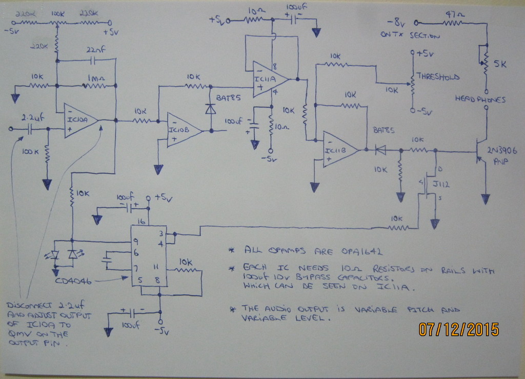

                    • mister might try using this audio schema mick but I still doubt if I can.Click image for larger version
                      • Is there a Sprint layout file?
                        • Yes. Search the forum VCO.
