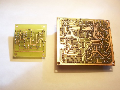

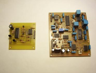

        • My IDX-PRO PCBĀ“s
          Some pictures

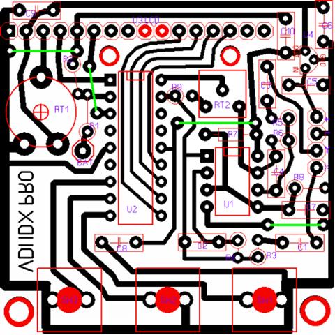

                      • Smaller VDI PCB
                        Hello! Here is the PCB of the VDI in 5x5 cm in case anyone needs it. I do not know if it is very small and if the proximity of the tracks can be a problem. Please DO NOT USE until check that everything is correct, I think so, but I'm only a hobbyist and I can have made a mistake (which I do appreciate you letting me know)
                        Well, that's all.
                        ”Hola! Aquí va el PCB del VDI en 5x5 cm en caso de que alguien lo necesite. No sé si es muy pequeño y si la proximidad de las pistas pueda ser un problema. Por favor NO USAR hasta tanto comprobar que todo estÔ correcto, yo creo que sí, pero sólo soy un hobbista y puedo haber cometido algún error (que agradeceré me hagan saber)
                        Bueno, es todo.
                        Saludos

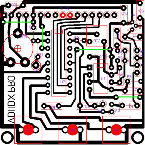

                        • I like your small dimension board but not the expense of mounting holes. It would be nice to have four holes, instead of two. All user interface board are exposed for mechanical stress due push-button or encoder activities.
                          • Originally posted by lutek View Post
                            What I often do (with or without mounting holes in a PCB!) is to put a spot of hot melting glue at each corner and press it onto some part of the inside of the box or similar.
                            It holds well but the hold can be broken with careful use of a screwdriver or similar if needed......Does not need any metallic hardware like screws, nuts and standoffs, nor do I need to drill holes, which may be a problem anyway with certain sensitive designs....
                            For me its the perfect answer to the problems of mounting PCBs inside (usually) plastic boxes.
                            Note, if it doesn't stick, clean with Meths/Denatured alcohol first.
                            Andy.
                            • 4 holes
                              I had thought some kind of solution that Andy gave to fix the board. Either way, it was not a big deal to add two small holes more (There“s no more space ). They are asymmetric with respect to the others, but they are there. Now is your problem.
                              Here goes, with other minor design fixes.
                              Best regards
                              Fabian
                              • Fabian you have one little mistake on your board. R3 need to be conected for other side of R4.
