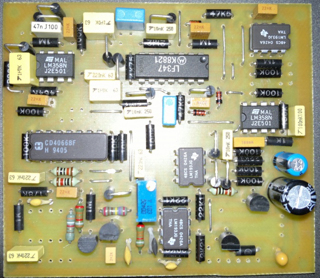

    • Hello, I would like to know what schematic of pro idx is used today. I made my card with LF747, I have a diagram but it did not seem to match my card. In fact I noticed that there is a switch called "black sand" I do not know what it is. On the diagram that I have noticed that I can power the detector with 4 batteries and some assembly converts 12 volts out I did not mount this part on my card. could you help me thank you.
      I leave you a picture of the card I made ​​for you to send me the schema matching thank you.Click image for larger version

      • Originally posted by Nicolas View Post
        Hi seadoggy
        You can replace that by a L78L05
        Best time
        The regulator on the IDX board is an 8 volt type! So you need to use at least 7808, 7809 will also work. Please note that 78XX regulators have relatively high drop voltage, they will not work with a 9 volt battery. You will need at least 12 volts input.
        • Originally posted by joop View Post
          Hi Joop
          Sorry you are right the LM 2930-8 is a Regulator 8v
          But the L78L05 is equivalent for the U4 MCP1703 on the board LCD
          Thx Joop

                      • hello, I made the first test of the pro idx. I have some questions.
                        I have a slight noise threshold at the time of testing, I thought with the threshold knob that I could remove it but I can not. there no solution? Another question, when I toggle the switch to pinpoint it beep continuously good I noticed that almost approaching a currency coils it beep than the center when I spend the money on it but without money mode pinpoint all sounds time are normal?
                        • Originally posted by ashefr10 View Post
                          Here is the way that it should work:
                          http://www.youtube.com/watch?v=bVbGz...IoCBxg&index=2
                          First part in video is pinpoint mode, doing ground balance with a ferrite rod. The pinpoint mode should be able to be adjusted so the IDX is completely silent.. it does however interact with the disc mode, meaning if PP mode is set too low, it will reduce sensitivity in the disc mode and if PP mode is set too high, disc mode will be noisy. I then swithed to disc mode for testing a gold ring.
                          If you cannot get rid of the threshold, then you have it assembled incorrectly or a bad component.
