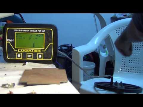

                    • DM-1 on Tesoro:
                      Connection descriptions:
                      http://www.lugatek.com/forum/index.p...sg5882#msg5882
