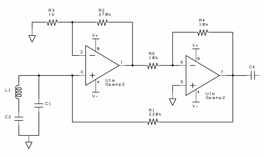

    The 3035 substitute is not straightforward as this part is actually 3 amplifiers in one 10-pin package. I will have to redesign the receiver around 1 or 2 op-amps, maybe a dual low-noise variety.
    I was not aware that the 3035 was obsolete, apparently has been for 15 years or more! I think I have some of these somewhere, maybe I should dig one out for Carlos. Still, the design needs to be fixed for available parts.

                Any general purpose opamp. I think Gary's solution exactly replicates the internal circuitry of the CA3035, which was probably designed in the 1960's when a 3-transistor IC was a Big Deal. Using the opamp solution might give you a little more flexibility and (maybe) a little less power, but it won't make a lot of difference in the overall project.

                  Hi.
                  T/R Locator working at 200 Khz so what about IC1 bandwidth if gain = 270 (270k/1k). A general purpose op amp has a unity gain bandwidth 10 Mhz max.
                  Maybe two op amp with each gain 10.. 20 to be better.
                    The Current Draw on my circuit is about 27 mA, for all three amplifiers with a suppy voltage of 9 volts.
                    Stability is Excellent.
                    And if your going to try and achieve the same results as my circuit using op-amps, I really doubt your circuit will be Physically any Smaller.
                    "The CA3035 Contains 3 Seperate Amplifiers", each with a Very High Gain and a Wide Frequency Response.

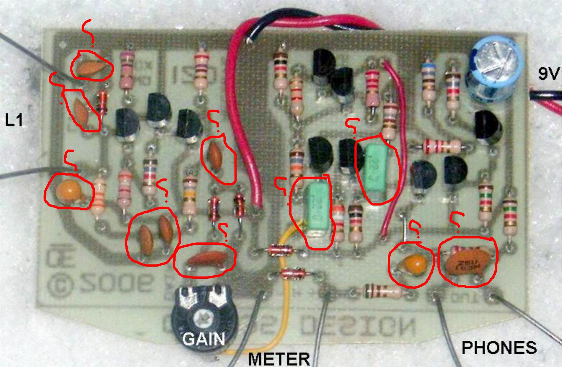

                      Hello brother is molded circuit capacitors list boxes russian on Tampa Bay Mqdarshvn You've got me so I do not know what's Shmarshvn Thank youClick image for larger version

                            do you have schematic and values ?
                              I Designed this PCB and Somewhere I Have the Schematic.
                              But I am going away till Sunday.
                              Sorry, No Time to look for it Now!.
                              PLEASE, Will you send me an EMAIL, to Remind me to Find it?,
                              When I get back Home on Sunday.
                              Merry Christmas...........Gary
