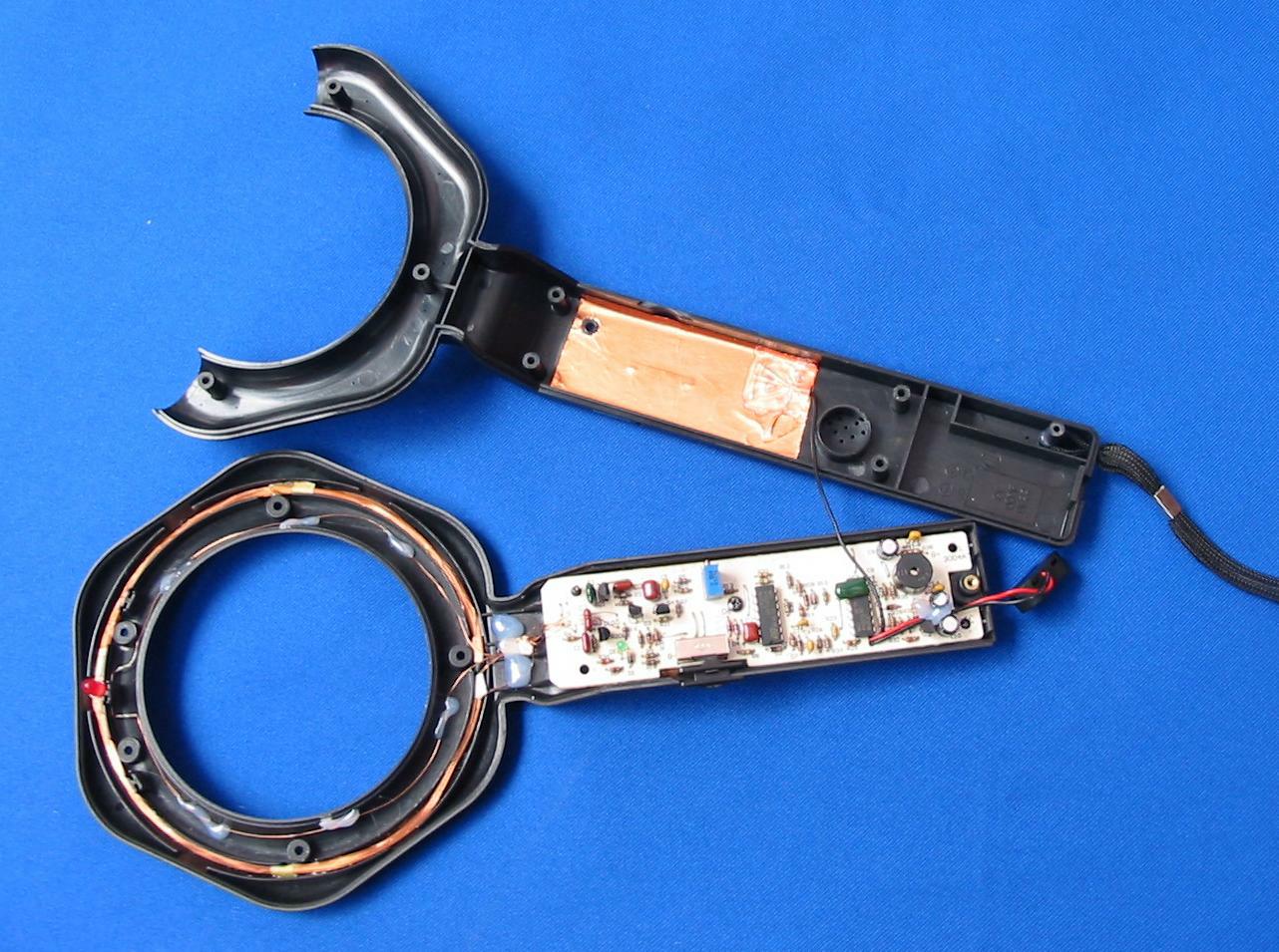

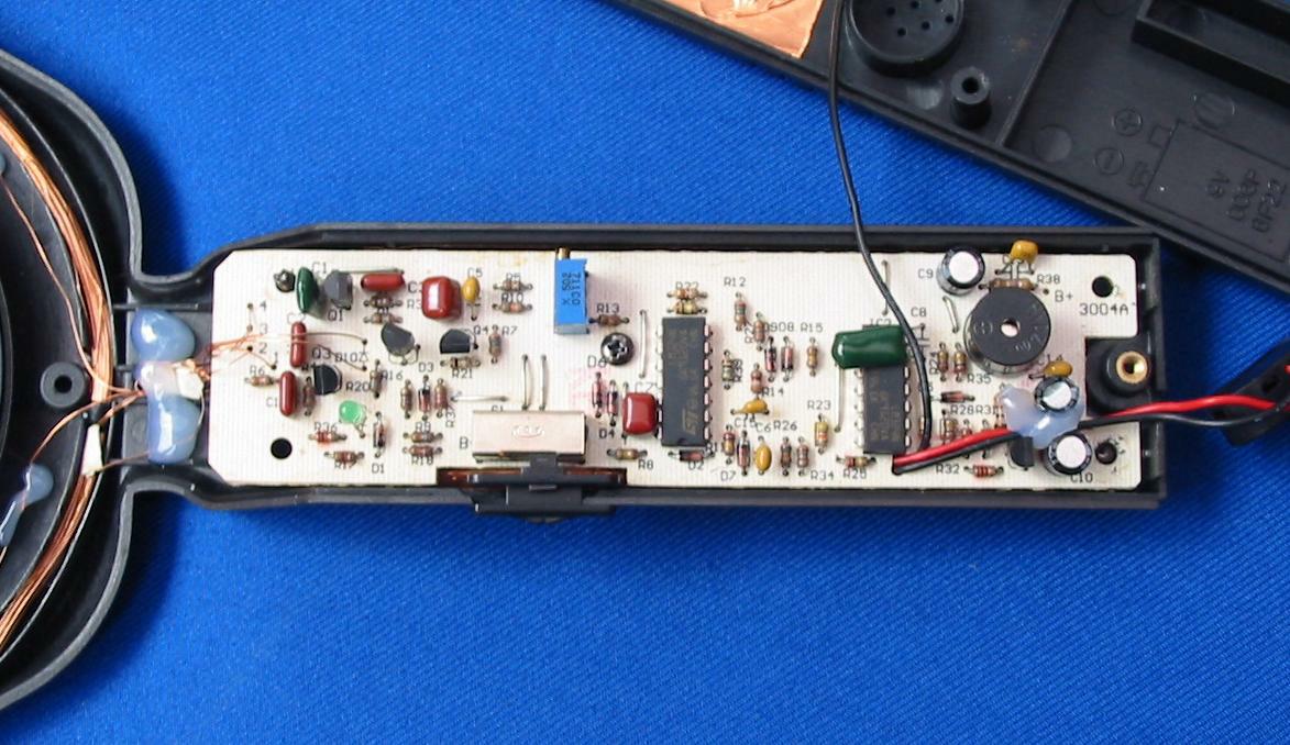

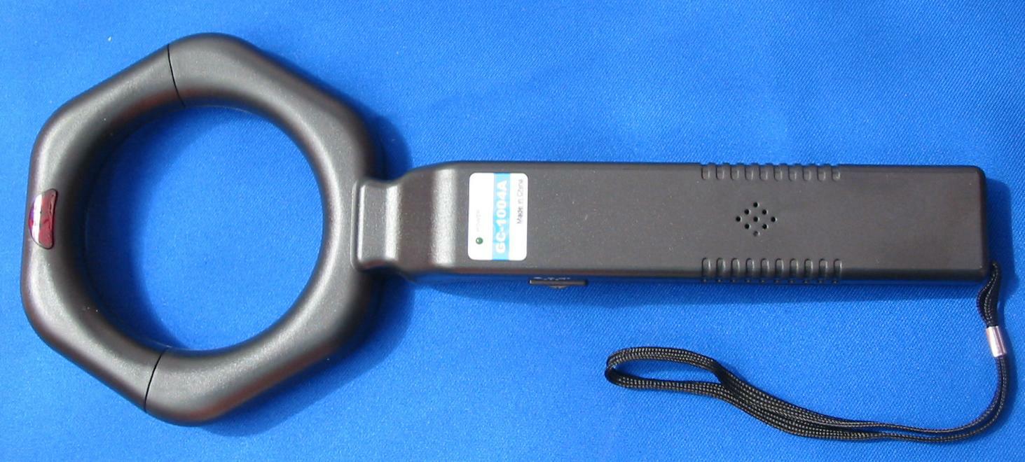

    For 12 Dlls i bought this one in a store...how the Chinese make this price !!! ...mysteries
    Sensitivity is good for this 4 inch coil diameter ...a 3/4 small gold ring at 4 inch detected well... and you have the possibility to adjust for outside the trimmer (a small hole)

    Do you know if it's a PI, or an off-resonance detector?
      Hi Alexismex
      How it is assebled together? By screws? Do you have picture of assembled item from back side?
        Hello ,
        Assemble with 10 screws you can see the hole assembling in the photos , i will check the Vlf frequency to morrow...

          Product Description GC-1004 Competitively-Priced Metal Detector
          with Portable Handle
          • Sensitivity adjustment, can reach up to 5cm for a US quarter
          • Either only LED lights or Buzzer and LED both indicate when metal is detected(GC1004A).
          • Both buzzer and LED indication(GC1004B)
          • Low battery alert
          • One 9V battery required (not included in the product)
          • Current drain: 8mA ( min ), ≤60mA ( max )
          • Operating Waveform: Sine wave Frequency 22.5KHz ±10%
          • Sensitivity: 3 inches for a US quarter
          • Min. Operating Voltage: 7V DC
          • Portable handle
          • GB Dimension: 362 x 155 x 53mm
          • Carton Box: 530 x 330 x 395mm (20pcs)
          • Carton G/NW: 8/7 Kg
          • 20’ container qty: 7,500pcs
          • 40’ container qty: 17,000pcs

            5 screws in coil housing? Very unusual.
            According all data it is not PI.

              They don't seem to be able to convert between metric and imperial.
              5cm = 1.97", and 7.62c, = 3".
              I guess 3" for a US quarter is the correct one.
              My suspicion is that it's an off-resonance detector.
