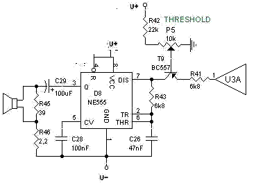

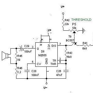

            Hi friend's
            please let me know, can i use the deltapulse sound generator in surf pi? if yes please let me know how? ( please drow in schematic)
            thanks in advance
              Originally posted by usta View Post
              Hi friend's
              thanks in advance
              Usta, simply connect it to output of U3A in schematic on post #10 or #12.

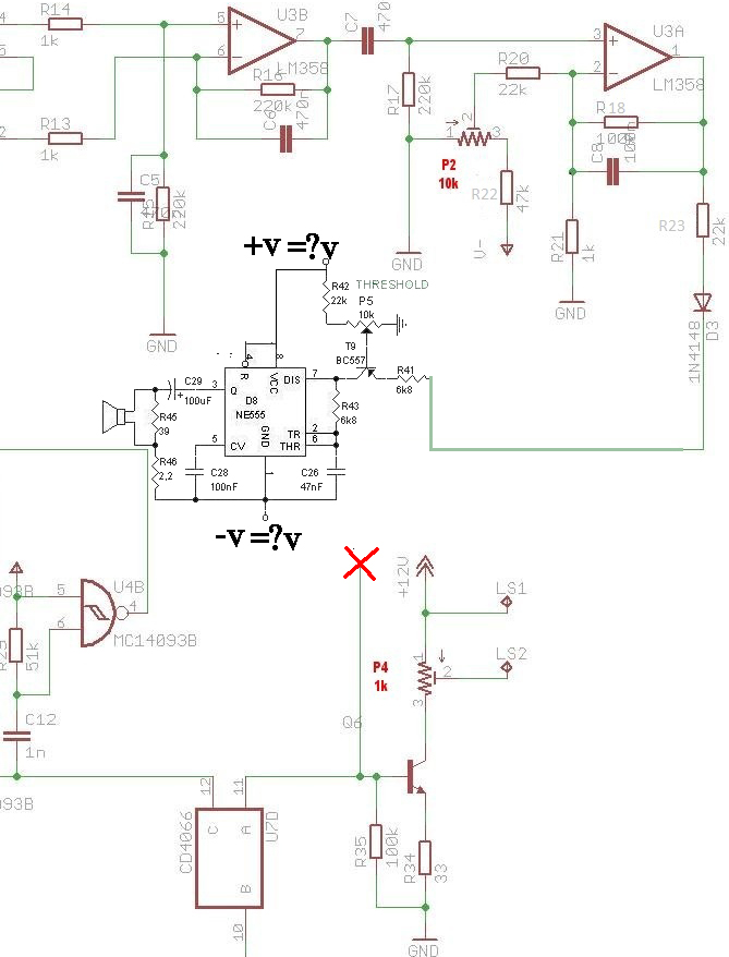

                thank you Mr
                is this correct?!
                and +v and -v connect to where?(for example +v to +12 volt or +5 volt?) (and -v to -5volt or GND?)
                thanks in advance

                    Ok, so now I'm confused.
                    What is the Propper Values for R 18 and R 22?
                      if you populated your pcb by looking at the screen print on the board - you will have made it wrong.
                      original schematic is correct
                      resistor between pin 1 and 2 of U3a is - and should be 100k... (R22)
                      R18 is 47k and should go from end of the variable resistor to -ve rail.
                      build it like my text for extra depth
