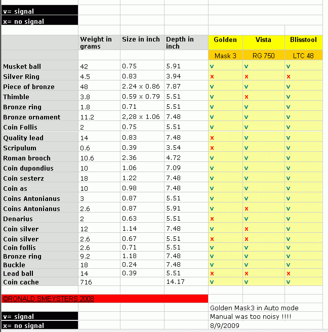

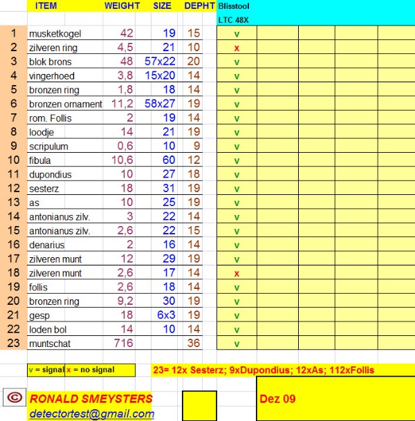

          Below you have a depth overwiew from the as serious known
          "belgium test" 1.5 years ago (the capture of the attached jpg
          was on August 2010).
          The green v means OK - found, and not alot machines have
          almost everywhere that v! The LTC48 was the model before
          the LTC64 came out but very similar concerning depth.

            Please tell me, how one can measure the target depth to within 0.01 inch?
              Like Mrand, I'd like to know how to do a depth test to an accuracy of 2 decimal places.

                Is it just me, or are none of those depths in the table above really challenging? For example, the silver coin, 2.6 grams, it sounds similar to a U.S dime, or a British sixpence. 5.5 inches isn't a challenge for any machine, is it? Decent modern machines will find one of them at 8 to 9 inches, I think, and multi-freq machines maybe 10 - 12 inches.

                  Looks like 48 is better than 64
                  According to this test,64 can not detect roman dupondius at 18cm
                  http://www.metalldetektortest.de/Bel...blisstool.html
                        This is caused by the conversion calculations from centimeters to inches.
                        • #72
                          On the original website at metalldetektortest it is explained how these tests are done. They first cancel out a 7 cm long iron nail. All of the objects are buried next to iron. So it is not only a depth test, but also a test for discrimination.
                          • #73
                            Thanks for that explanation and link, now I see it - ein grosser nagel 7cm. That would explain why the entry-level machines fail so badly. They all 'null out' on the iron, and can't even find objects close to the surface sometimes.
