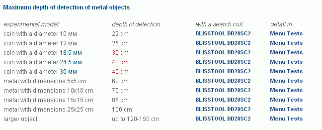

                      Below the old Blisstool LTC64 depth info from their homepage, January 2011:
                          The content of that table is an shameless fabrication.
                          That distances of detection could be reached in the open space, not in real earth soil.
                          In the real conditions, the blistool metaldetector is impotent to detect roman denarius at 14 cm depth, what we can see here: http://www.geotech1.com/forums/showp...4&postcount=68
                          • very well now it seems we have no more other problems
                            than wrong depth values.
                            Well, he has used some "experimental model" - perhaps the
                            newest and for test purposes special modified Blisstool model
                            (pitched voltage, high stable electronical parts etc.) but at least
                            now with the depth improved v3 those values haven't changed:
                            http://blisstool.com/index.php?optio...mid=96&lang=en
                            But of course there should be still huge difference if we compare
                            this with our german test-results:
                            10mm: scripulum / lead ball: depth: 9cm / 14cm
                            blisstool page experimental model (thin) coin 10mm: depth 22cm
                            18mm: bronze ring / coin follis: depth each 14cm
                            blisstool page experimental model coin 18.5mm: depth 35cm
                            25 / 27mm รก 10 grams: coin as / coin dupondius: depth 19-18cm
                            blisstool page experimental model (thin) coin 24.5mm: depth 40cm
                            So at the Blisstool Page we have almost the double amount of
                            depth which would be completly inacceptable if there are no
                            special factors we also have to calculate.
                            Personal test 1 Euro (23mm):
                            within close living-room electricity @ air:
                            threshold 0: 18cm
                            threshold 3: 22cm
                            threshold 5: 27cm
                            However under good conditions outside threshold 8-9 is no problem and could result @ 33-36cm (not tested yet)
                            Depending on the soil, close distance coil to ground and no electricity lines nearby this may result in 25-30cm for a buried 1 Euro coin for trained ears and 20-25cm in almost silent (for Blisstool-Newbies or real relaxing) mode.
                            Those are just my personal results and if the LTC64 v3
                            has a real good depth improvement 1 Euro may be found buried at 35cm which would be just 5cm less than with those posted experimental detector tests 24.5mm @ 40cm.
                            The 1,5mm is not much difference - in this range 1mm of larger
                            diameter gives 1cm more depth.
                            So if the posted results at the blisstool tests are in air tests -
                            that's the big question - there even wouldn't be much difference
                            to my ("old") model!
                            We have to find out about this because depending on the
