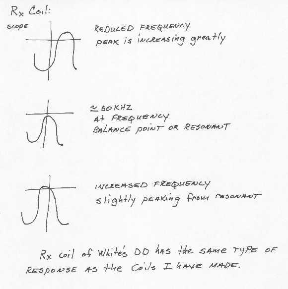

        I just put my second coil,Rx,on the scope and instead of peaking for the resonance it was the valley with the proper value. Does this mean that I am 180 degrees out because the valley was 49.9 khz( looking for 50 khz)? The coil is almost on the money. The resistance is only 0.16 ohms over the exact number and the inductance is 0.16 mh below exact number. Any help what to do to match the store bought coil to mine? Thanks, Rick S

              It is the same way one finds the natural reasonant frequency peak on a scope, but the wave direction is going in the negitive direction instead of the positive. You still see a positive sine wave, but peak reduction is downward or negitive direction. It is not much in the negitive direction either. When 50khz is reached then the normal left and to the right reduction occurs. I hoped I explained it better. A drawing would be very helpful, but I haven't learn how to post a picture on the web to down load to this forum. Any help on the computer end would be nice. I could email you Carl with a picture and better numbers if you want. Thanks Rick S

                  I hope this will help clarify the scope situation. The Rx on the White's and the ones I have built have the same chacteristics with the peak and resonance. I wonder if I have to do so adjustments on the scope. I have put a resister in series between the frequency generator and the coil. I hooked up one of my coil arrangement DD and the Rx coil with the high ohms and inductance. That was way to sensitive, so I had another Rx coil and tried a lower inductance and ohms. It is closer, but still not there. I have to get the coils with a closer match. Rick S
                    Re: GMVSAT DD Coil
                    So what it looks like is the signal is dipping slightly at resonance instead of peaking. Doesn't make sense, unless maybe you have a series capacitance on the coil. Try different values for the series resistor, see if what you have is too high or too low. Can't see why it would work for one coil and not the other.
