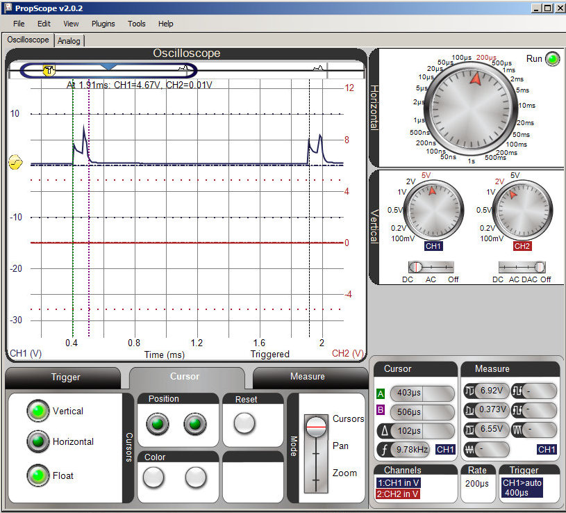

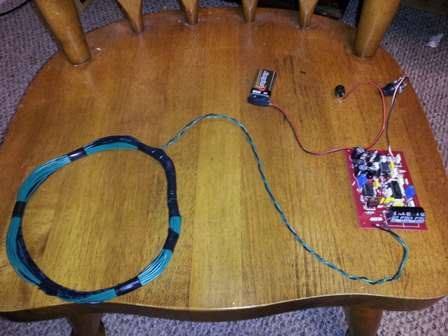

                Well, I built the Baracuda kit from Silverdog last night. I tested it today, and I have to say I'm pretty darn impressed. That was the first detector I built (other than a couple simple little BFOs), and it worked flawlessly. Even with the hokey little coil I wound around a 7" paint can, the detection depth was a good 5-7". I did tweak the delay and offset a bit, but the components are so darn well matched up, I had a ton of leeway - it worked right off the bat on power up. The coil was simply 25 turns of 22AWG, which was a bit low inductance, but it ran pretty well. I suspect if I'm very careful, and use smaller wire with a larger diameter, than depth should increase pretty well.
                I did "simulate" the coil in a blanket, and it didn't do too badly. I believe it will be fairly straight forward on sewing that into a blanket if I so choose. I suspect I will prefer a rigid coil though, especially if I want to use to Rover to pinpoint.

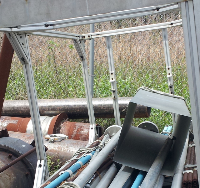

                I was able to secure my framing materials. Its going to look pretty sweet with the 80/20 frame.

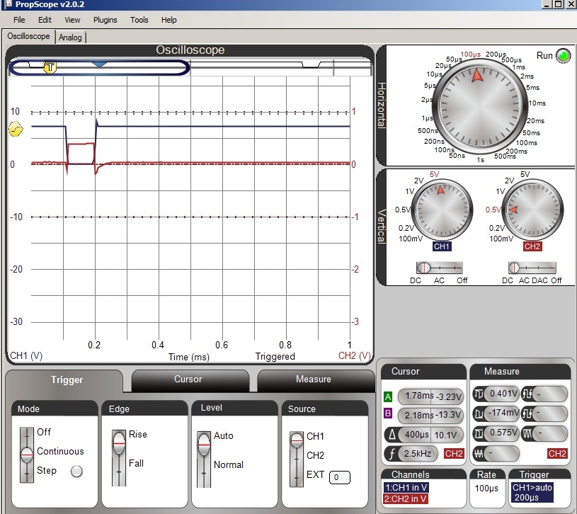

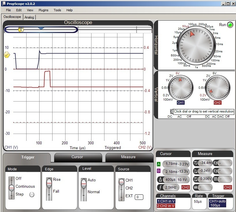

                The detector output audio is wonderfully clean. I had a 650hz pulse of 100uS which I can easily route into the sound card for detection in Flowstone.
                Attached are some pictures of 80/20 framing, 2 screenshots of the baracuda waveforms, the assembled Baracuda kit and coil, and a screenshot of the audio pulse waveform. So far so good.
                  Congrats on the Cuda build, that was fast.
                  One thing get rid of that 9v batt and run it off nicads

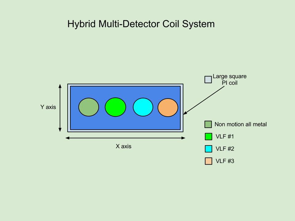

                          Hybrid Multi-Detector Coil System
                          Ok, I like the food coloring idea. I'll go with that for now. I believe that, coupled with the coarse GPS and the discussed GPS triangulation techniques, I can come back to targets later pretty effectively.
                          For the coil, as much as I like a blanket concept, I think it may be somewhat limited. A remote rover platform like this allows me to start thinking out of the box on a lot of issues, including detector and coil designs. With the rover platform, I can attempt things that would be difficult, if not impossible to do with a hand detector.

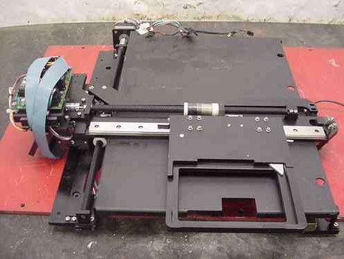

                          For one thing, I'm looking at building the Rover around a Hybrid, multi-detector coil system. This system will work by switching to the best detector design for the task at hand. The assembly will consist of a non-metallic XY base, with small, individual coils located inside of a large PI coil on the periphery of the XY base. Each individual coil would use a different detector circuit. Each circuit's individual coil would only be powered up when being used. This would keep the coils from interfering with each other when not in use.
                          For general scanning, the rover moves forward, using the large, square PI coil located on the XY base, such as the Barracuda PI circuit.
                          Next, once a target is detected, the operator can select whatever coil is desired. The system would switch over to the desired circuit and coil. The operator would then manipulate the XY axis using the operator's Xbox controller thumb joystick, and would center the target as best as possible inside the selected coil. Once satisfied that the target is centered, the operator will hit the "save" button, the Xbox controller's green "A" button. The target's position is now stored in the system.
                          Next the operator can choose which coil is desired next. Once selected, the system will drive the XY axis automatically to center the desired coil over the previously stored target position. Once the new coil has reached the target position, the operator can again manually move XY to determine if the target is trash or not. This process can be repeated for different coils if desired. I have 4 coils shown in the sketch, but I will see what works best, it may need only 2 or 3. Eventually, this whole process can be automated at some point, but initially these steps will be done manually. If I can manage it, I will simply build a complex, multi-loop coil design, with each loop functioning for a different detector.
                          Another thing that's possible with this platform is detector design. For all that's possible with super advanced DSP circuitry and the best detectors, nothing beats what a human brain is capable of with training. Really, in some regards, a good detector design is attempting to emulate would a well-trained human being can do with a simple detector, and his ability to hear and discriminate different audio feedback clues. Another thing modern detectors do is to automate the settings necessary to allow an operator to not have to think about or remember what settings need to be adjusted for a particular method. A basic detector can be interfaced to a control system to allow for remote adjustment of the basic controls such as threshhold, offset, delays, etc. These positions can be saved, scaled, etc for many different possibilites. A single button on the GUI can instantly switch to a completely different setup, and the operator can select each individual setting and scan using that. On a handheld detector, that can get downright brutal, with different menu levels, options, etc, that the operator has to flip through, where a GUI on a LCD screen, the operator can select these with just a mouse click. I'm going to interface each detector circuit to A/D channels that can be tied into the GUI and system. This also allows for automatic system control of these features as well. The sky's the limit. My initial build of the system will bring in the hardware and basic slider controls on the touch screen, later on I can add the automatic switching and recipe functionality.
                          Here's where i need some more help. I want to use detector designs that are analog in nature, i.e pots to control features, but I want audio circuits to be rich with information. This gives me the ability to interface all of the features of a particular detector circuit, and also gives me the ability to bring in the audio for sampling that later on I can do a lot with in the PC. Simplfied go/no go audio circuits that may be good for an operator, might not be so desirable in a system capable of some heavy duty analysis of the audio.
                          A good example of what I call a rich audio system is a White's XLT detector, and I'm sure there are others. With all of the various audio options turned on, it basically gives information overload to an operator's ears. However, an automated sampling system might be able to do wonders with all that audio information.
                          What I need are detector design's that have those levels of audio discrimination as well as lots of control of metal detector functionality via analog interfacing, i.e. pots, The more the better.
                          Anyone who knows of suitable MD designs, with these features, please feel free to speak up. I'm new enough to this hobby to not be familiar enough with all of the dozens of various MD designs out there, of which I'm sure have features that would be beneficial to me on the rover. I'm not limited to how many designs I could incorporate into this hybrid. With this system, theoretically, I could use this platform to benchmark different detector designs fairly easily. These different circuits would all use the same common rover platform, eliminating the many differences in construction, movement, and technique, inherent with different MD builds. Using this system, it might actually be quite easy to really narrow down which detector designs are truly the most optimal.
                          I'd love some ideas on this please. Let me know what you think.

                            More on Hybrid
                            The more I think about it, the XY base will need a Zaxis. This XYZ will use a complex, multi-loop coil, on an arm extending out from the rover. I may simply just stack coils in layers, and just switch in whichever layer I need for the detector.
                            The Z axis is also needed for pinpointing.
