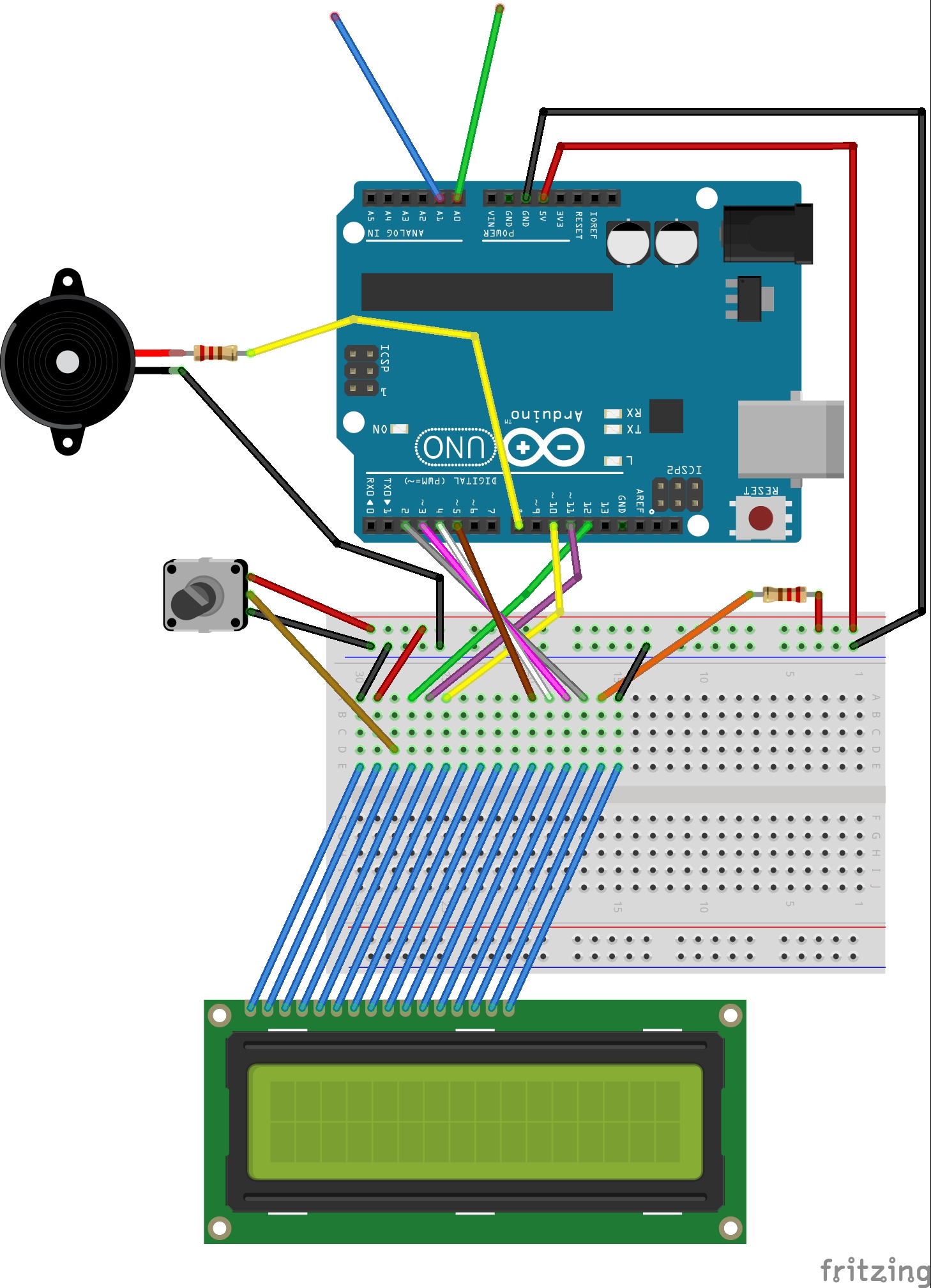

                • Hello Don!
                  Any news, upgrades?
                  With huge delay i got my UNO on the bench...
                  • A good alternative to Moteino could be Teensy 3.2 (MK20DX256 - 32 bit ARM - Cortex-M4 - 72 MHz).
                    37 ksps for 16 bit ADC, seems to be quite good for VDI purpose.
                    I find this VDI made with PIC 18F4520 : http://www.aspeluut.nl/metaaldetector.php
                    • Teensy 3.2 seem to have nice specs, but it is also a power hog
                      • Is it a problem ? Nowadays batteries can provide enough power ;-)
                        I will try to port Arduino VDI code to Teensy 3.2.
