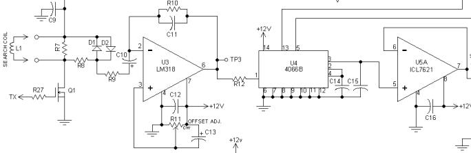

      Check out the blind squirrel and what it does with caps, sounds like your idea is similar.
      It only uses one cap.
      http://oldradiobuilder.com/mdetsp.html
        What rickodetrader is proposing is to take multiple samples along the decay curve, in a similar manner to bugwhiskers' idea. The blind squirrel does not have that feature, as it only takes one sample.
        If you look carefully at U4 (4066B), you will see that two of the analog gates are unused, and the other two are connected in series. There appears to be some charge shuttling going on between C14 (1nF) and C15 (10nF) - [what the purpose of this is I'm not sure, unless it's a switched capacitor filter] - but there's still just one sample being taken. The text only describes U4 as "the sample circuit".

          The simple blind squirrel schematic came to mind, I may be wrong, its a while since I studied the schematic, and was discussed on another forum, but I was under the impression from the very basic circuit description on the website, that Cap14 or Cap15 stored a voltage charge, which varied with a target, this charge was then monitored by U5A, U5B etc etc.
          All I was trying to point out to Rick in not so many words, was if C14 or C15 work this way in the simple blind squirrel schematic, then there is a good chance using multiple caps in the way he describes with multiple samples etc, has a good chance of working.
