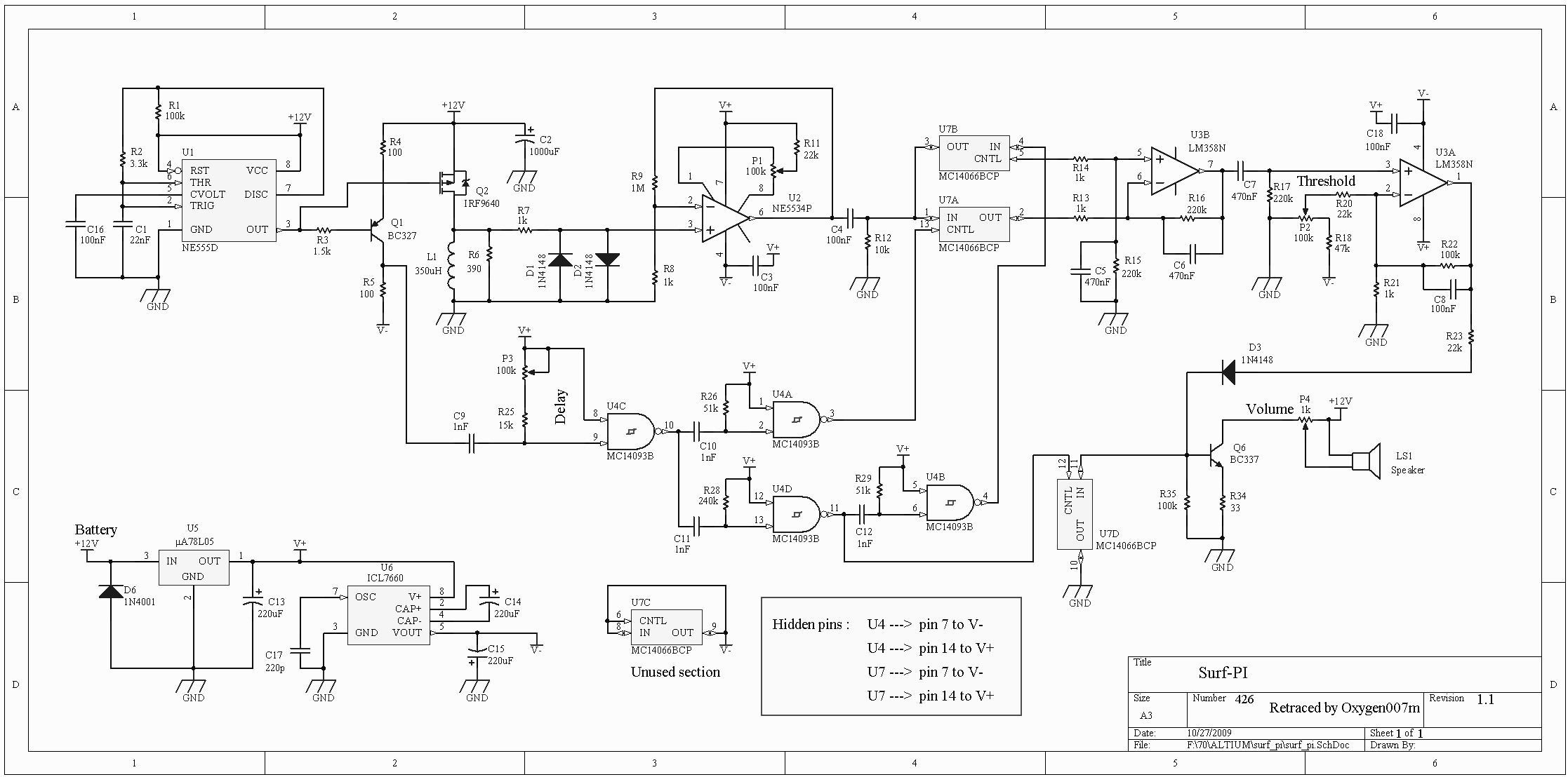

            Maybe a little late for this, but as I looked over Silverdog's PCB I noticed some areas where his circuitry does not match any of my existing schematic drawings.
            Would somebody please post a schematic that shows the (Silverdog) Surfmaster PI?
            That's what this is all about... right?
            I imagine there might be more than one version but I don't have any 't all.
            • #51
              longboard schematic
              Schematic for longboard at Silverdogs website ..
              http://www.silverdog.co.uk/shop/imag...ematic1_2A.JPG
