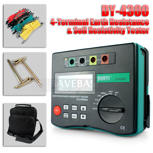

    Hi friends
    I will like to ask if anyone knows if the device show on the below link, is good to be used has an earth resistivity meter for treasure hunting.
    In advance many thanks
    Nelson
    http://www.ebay.com/itm/DY4300-2-3-4...item3a75ecf750
    With proper use and full understanding OF COURSE it can be used in soil survey.
    By proper understanding i mean to say that resistivity measurements of soil are very complex series of tasks.
    Before anybody decide to switch on such survey techniques; i suggest first to read splendid book: " Seeing Beneath the Soil" by Anthony Clark.
    Of course there are also other educative books and articles too.
    Personally; i made few EPE resmeters and started to learn to work with them. Not exactly what i imagined before. Not that simple and easy.
    But if performed on proper way: such methods can give very good results.

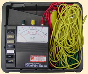

                        Won this for a penny on ebay 2 months ago , played in the garden with it, my mrs and daughter were rolling about with laughter at me.
                        I wonder if they will laugh one day when you dig out huge pot full with gold coins!! Ha!
                        "Who is laughing now!!!"

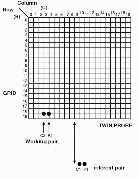

                        Even that simplified erm can be useful and do the very same job as top ones.
                        You have to learn how to set up the grid. You have to obey exact grid's rows and columns.
                        And finally you have to "logg" data ...i guess manually on paper.
                        Be patience and persistent. Always keep exactly the same distance between "working" probes.
                        Common setup for "our" kind of surveying is "Twin probe" setup.
                        I warmly suggest it to you. Put 2 "referent" probes away from grid, some 5-6 meters and leave those there. Move "working" probes through grid, cell by cell, row by row. Each sample (measurement) will need 3-4 seconds with probes in soil and than write down measured values. Remove to next row....etc..etc...etc.. Than next column. And next...etc..etc..
                        Let the step between measuring points in row be 0.5 meter. For a start.
                        So actually you will have grid with 0.5x0.5m cells.
                        Organize such grid on paper, print that paper, than use it on the field to write down your samples (measurements).
                        That's pretty skim explanation of how to properly work with erm.
                        Remember: "TWIN PROBE" setup is nice for a start. Later when you gain certain exepriences you can study other kinds of setups too.
                        That instrument you have there is quite alright although is analouge and simple.
                        Cheers!

                            So this meter with just 3 pole conections can also work?
                            I thougth that you need 4 pole conections, one par has a reference and the other two for tacking surveys.
                            Anyway i think that the unit from Chine will perform good to, cause it has 100 memories to store data.
