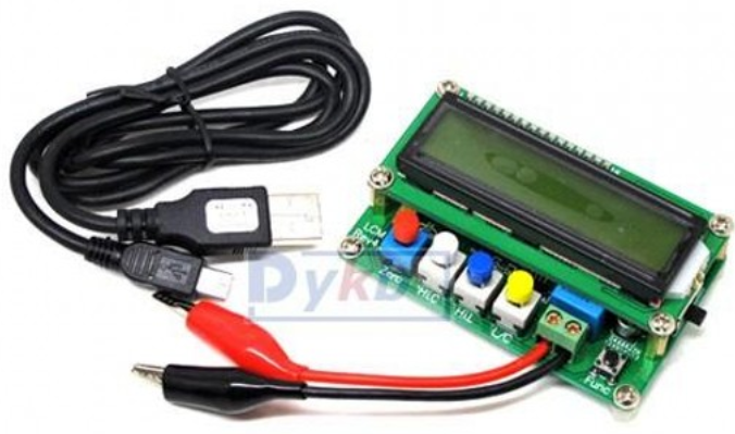

      How do you measure inductance of a coil? doesn't it need to be in circuit and with a scope?
      anyone recommend a ready built coil that would work? Would save so much hassle

        I bought one of these
        http://www.ebay.com/itm/NEW-LC100-A-...item3f0f54f5eb
          They don't have any of those on ebay in the Uk but do have this one that should work http://www.ebay.co.uk/itm/LCR-INDUCT...item5638cdd9f7
            I have one of those, it gave me bad readings. May just have been my particular unit.
            Ended up getting a better LCR meter but more expensive
