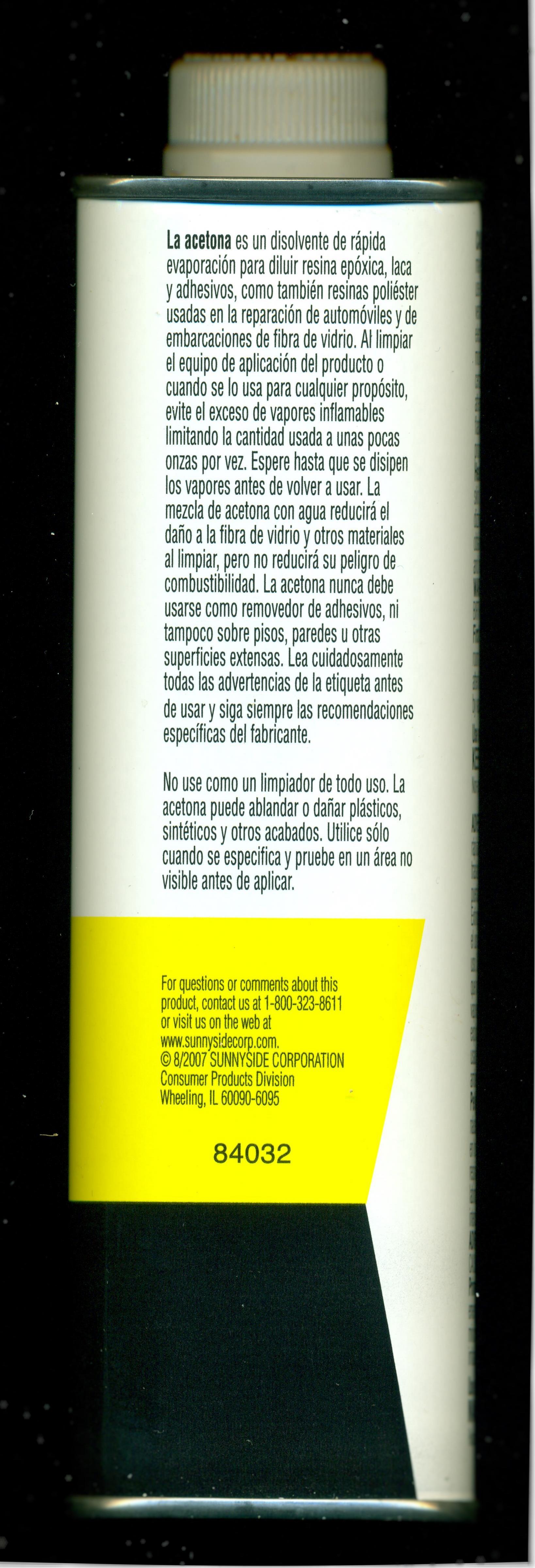

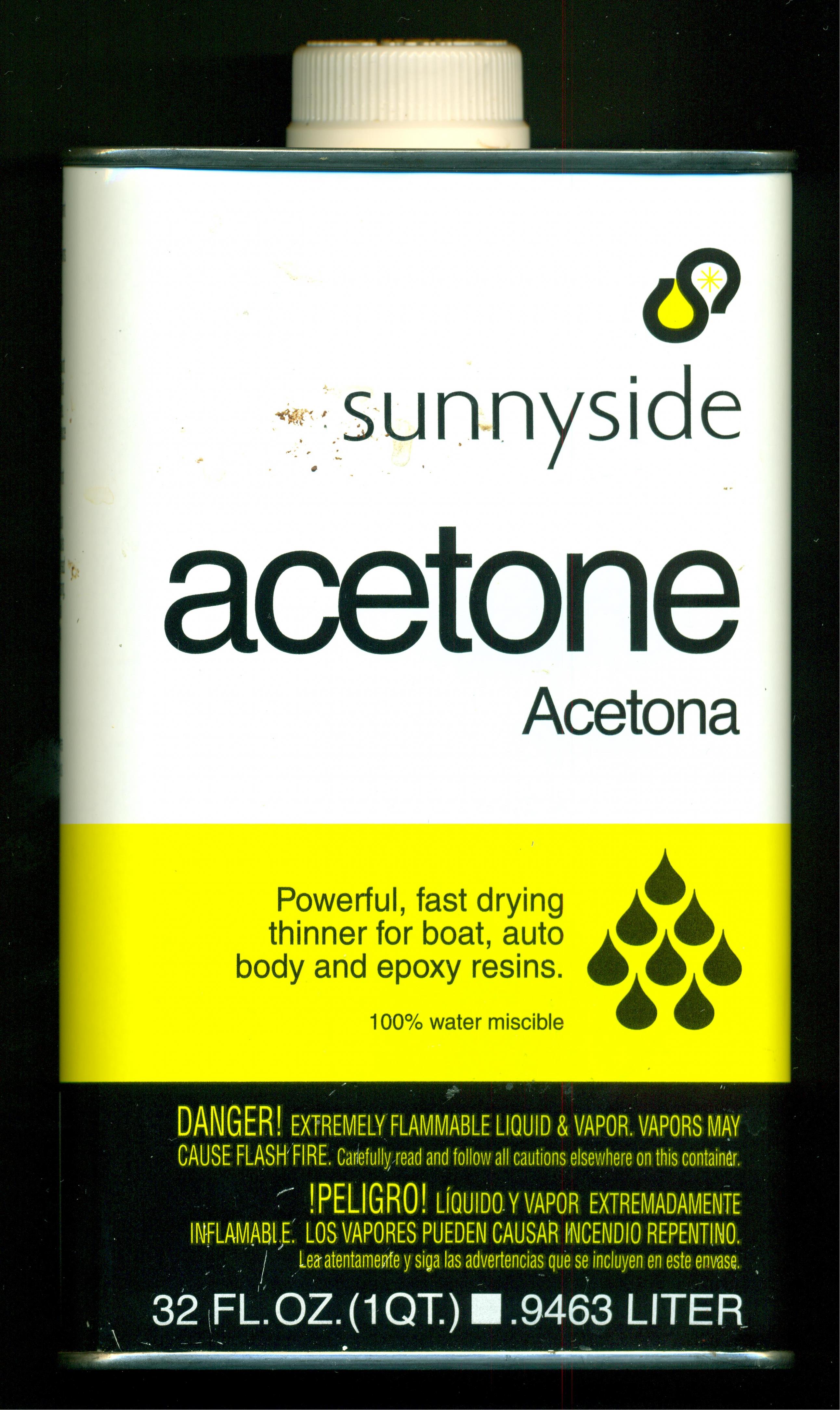

                    This will supplement my previous post #16, dated 9-03-2014, to attach some photos.
                    Placed one of my peanuts in water and it didn't dissolve one little bit, so not made of cornstarch as suggested by Carl-NC and geoscash1. Therefore, assume my peanuts are made of Polystyrene.
                    Anyway, here are two of the attachments I was having trouble posting in post #16, showing the brand of Acetone I used (which didn't completely dissolve my peanuts, but rather just formed a glob).
                    I have several photo views (bottom and side) of the glob in a small jar, but the attachment Manager wouldn't bring those files up in the browser window, so couldn't upload those. I clicked-on the "Add Files" button, but no luck. These last files are still saved in the same computer file folder as the two photos of the Acetone attached.
                    What am I doing wrong ? HELP !
                    ToddB66
