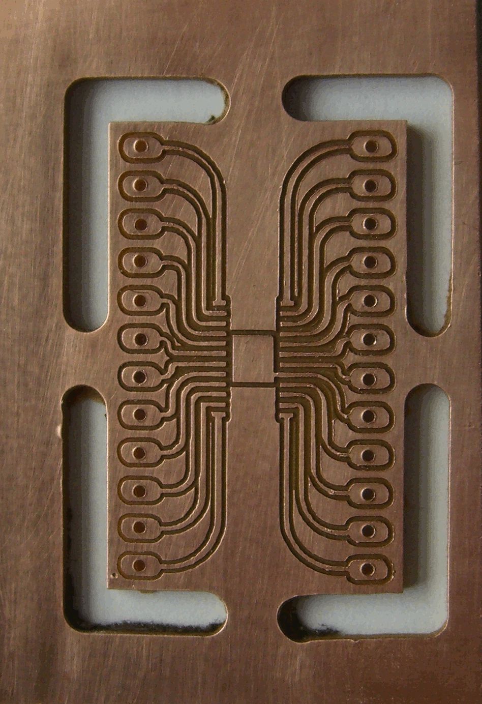

        Here's my attempt at a TSSOP to DIP24 adapter.

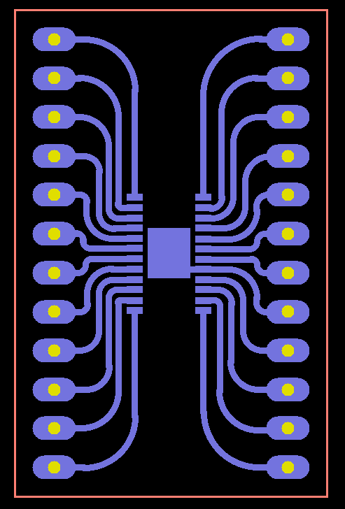

        and here's an image of the gerber layout.
Name:	Gerber Layout.gif
        The size, when the cutouts are removed, is 20mm x 32mm. Now I've just got to figure out how I'm going to solder the 24-pin SMD onto those tiny pins. As you can see from the traces, this is getting close to the limits of the machine. The SMD I need this for requires a metal pad under the chip. If you look carefully it's connected to one of the pins. You can buy these adapters on the internet, but the only reasonably priced ones come from Hong Kong, and it's pretty vague about the shipping charges. Although it says "FREE", it looks like there could be a customs charge and/or import duty. Also, it doesn't have the extra pad under the chip. So it's pretty much Hobson's Choice ... you have to make your own.
        The SMD pads are 0.45mm x 0.65mm, with a 0.65mm pitch. This leaves only a 0.2mm clearance. I managed to mill out the PCB in the image with a 30 degree V-shaped engraving bit. Unfortunately I don't know the size of the flat tip on the bit, but I highly suspect it's 0.2mm, the same as the required clearance. This seems to be the case, as the pads and clearance appear to be the same width on the finished product. Consequently, I've just ordered 10x carbide PCB engraving CNC bits with a 10 degree angle and a 0.1mm tip.
        In my original equation I didn't allow for the flatness of the tip, so I need to revisit that to see how much error it introduces in Z-depth calculation. Anyway - as you can see - the results are not bad for a tabletop CNC machine, but I think it can do better. Just need to wait for the new engraving bits to arrive.
        I was also able to correctly drill the holes for the DIP connector using the Excellon Drill File, and mill out the board outline.

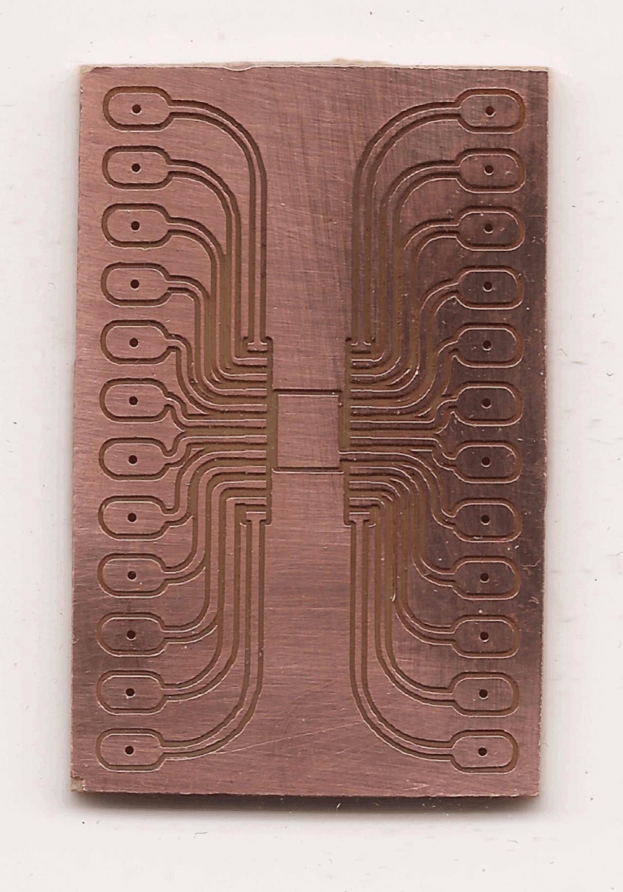

                  The 10-degree engraving bits eventually arrived (from China). I recalculated the Z-depth for a 5mil (0.127mm) isolation path using the updated equation, and the resultant TSSOP-to-DIP adapter board is attached below. Comparing this with the previous attempt (using a 30-degree engraving bit) you can see that the results are more precise. However, I did have to mill out the isolation paths 4 times, gradually increasing the Z-depth, in order to get the final result. I suspect the copper thickness is greater than the normal 1.37mil (35um). Also, even though the bed had been flattened, it appears that the board must be slightly uneven/warped.

                        For board flattening I've been using FlatCAM, which uses the G-Code file as a template. I think the problems I experienced with the TSSOP-to-DIP adapter were caused by the copper covered PCB being slightly warped, and the thickness of copper being greater than expected.
