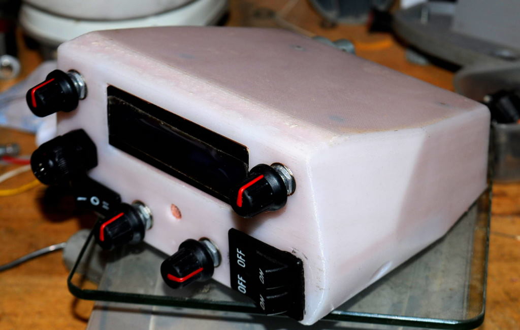

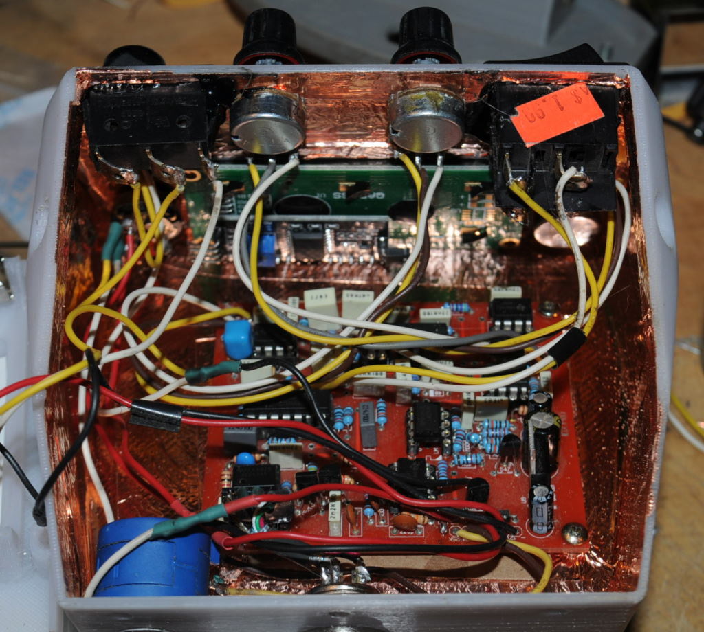

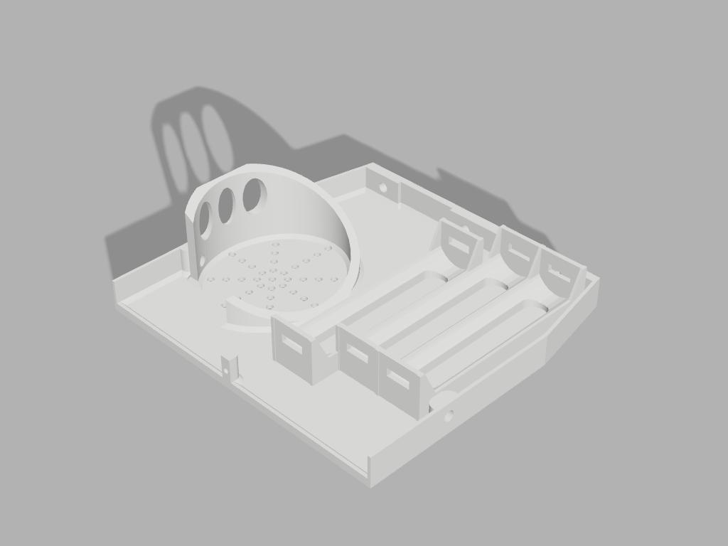

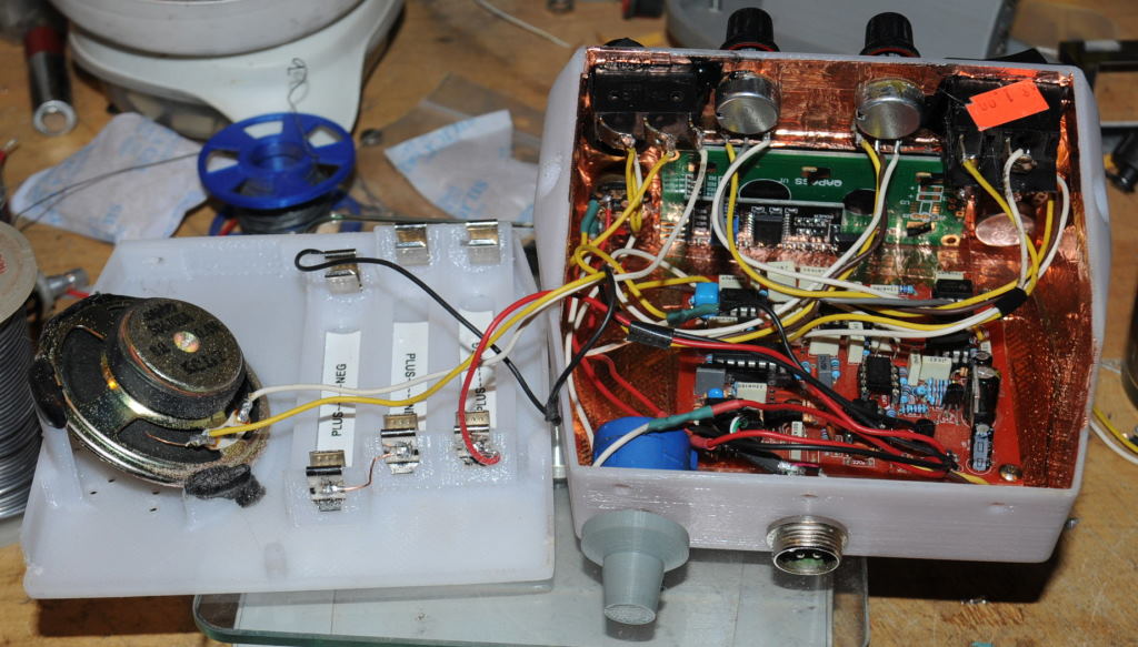

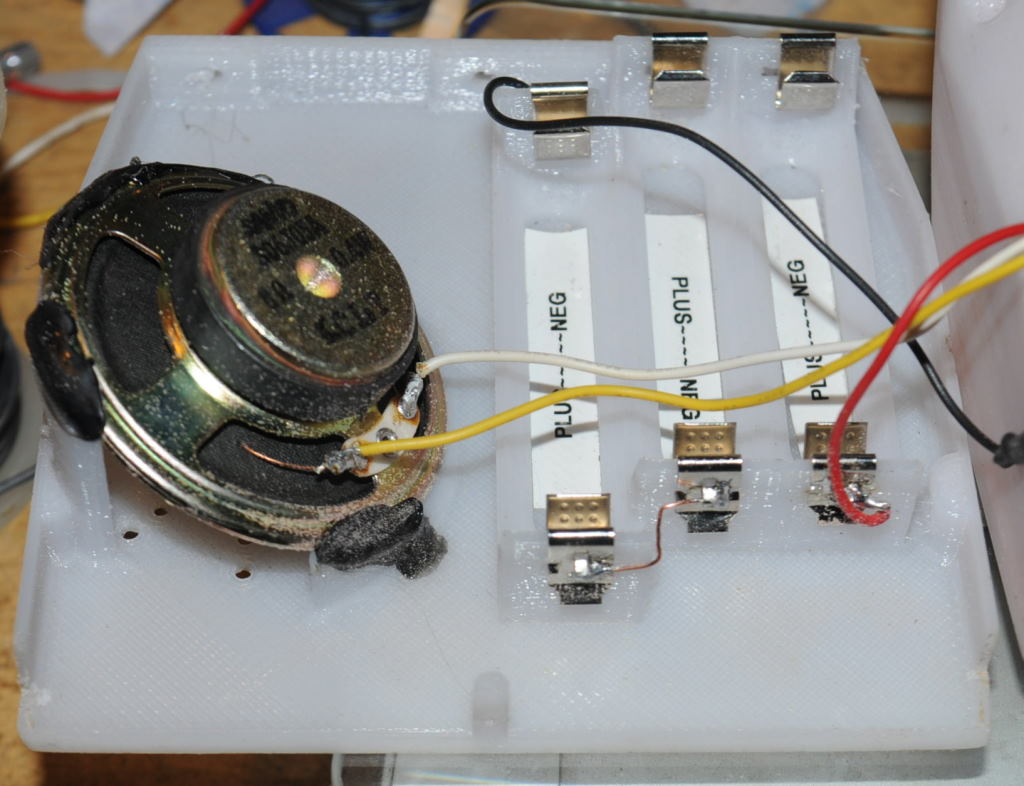

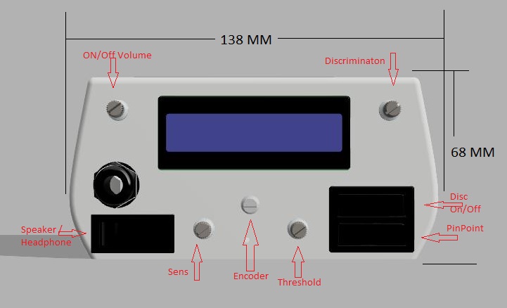

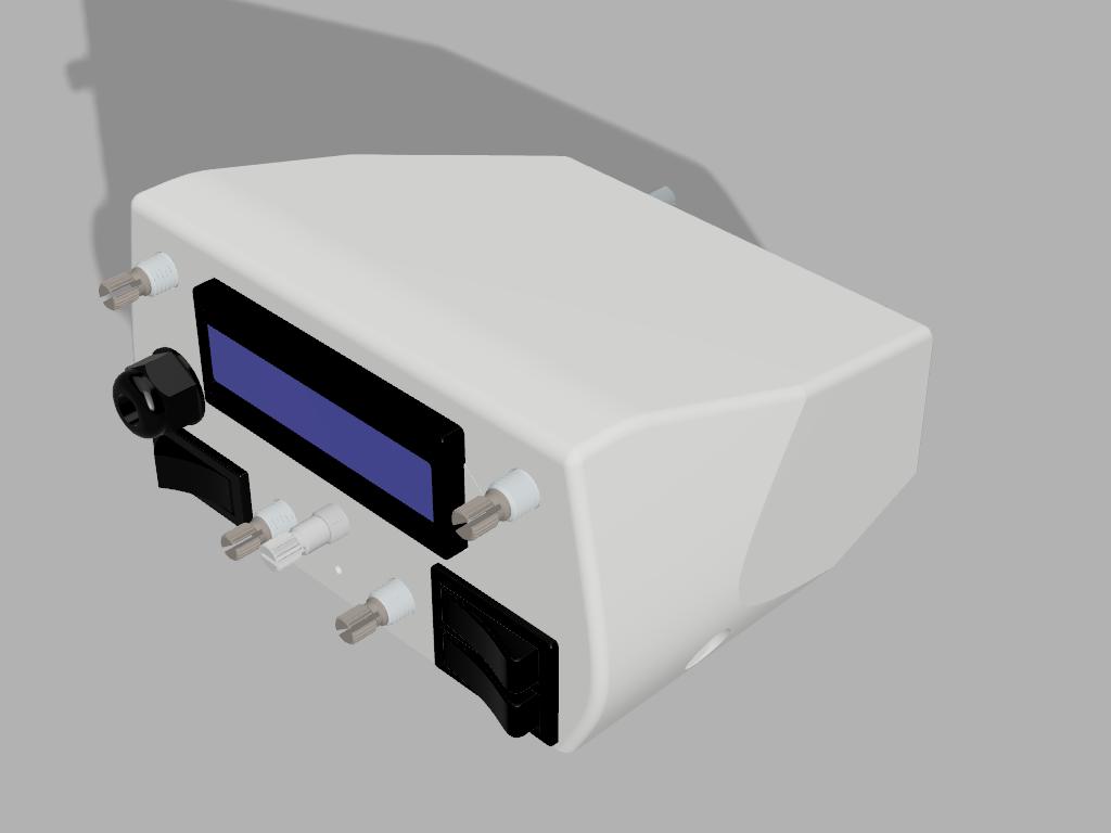

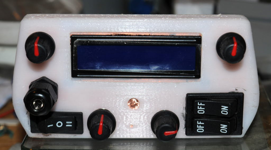

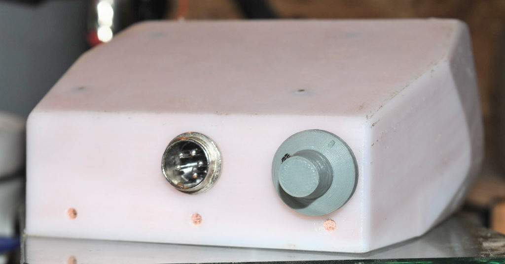

    Latest 3d printed box for IDX Pro, I started to use PetG more , which is what i used for this one. it an ok finish, ABS is more forgiving, I laced the inside with Copper tape for EMI shielding. its a little heavy with that bigger speaker and 3 18650's total weight is 390g still not to bad though. All i need to do is get that VDI working and all be all set for spring weather.
    Design art:

        Thanks, I am half tempted to remake something like it for the Lobo or TGSL, but, use that conductive pla, just to see if it would provided good RF shielding properties.

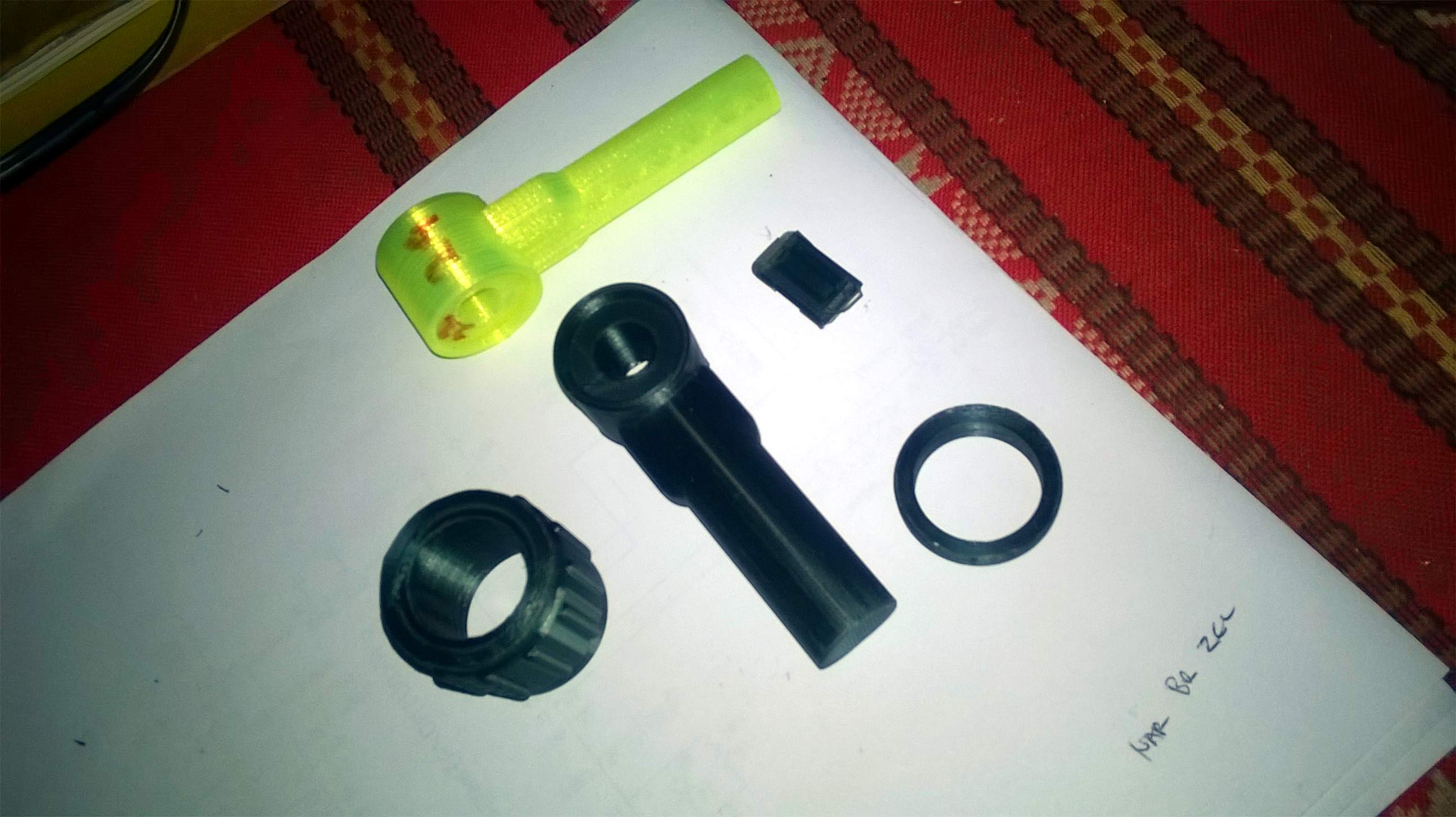

          I found that most delicate part to replicate is camlock.
          I spent whole day and 5 attempts to get it right.
          At the end it turns to be success.
          It is not generally applicable because of the specific tube dimensions.
