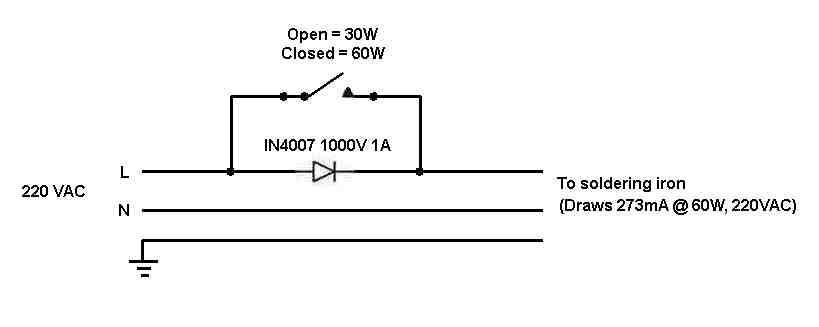

                        i was thinking some more about this today and did a little search on the net.
                        a quick and dirty way to drop 40-50w irons is by adding a lamp switch with a 4007 1000v 1w diode on the positive side,Click image for larger version

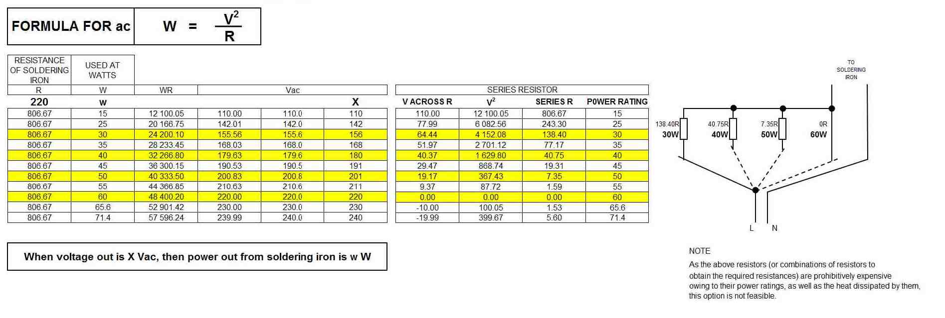

                        you can also add a lamp dimmer too, using a temp probe with this you could build your own adjustable soldering iron, if you start with an 80w and add a dimmer switch, you can find the temp scale with a thermocouple, build it all in a box and you have a ghetto adjustable iron Click image for larger version

                        of course this is not ideal but not everyone has the money or opportunity to buy a soldering station there are parts of the world where this info would be invaluable.
