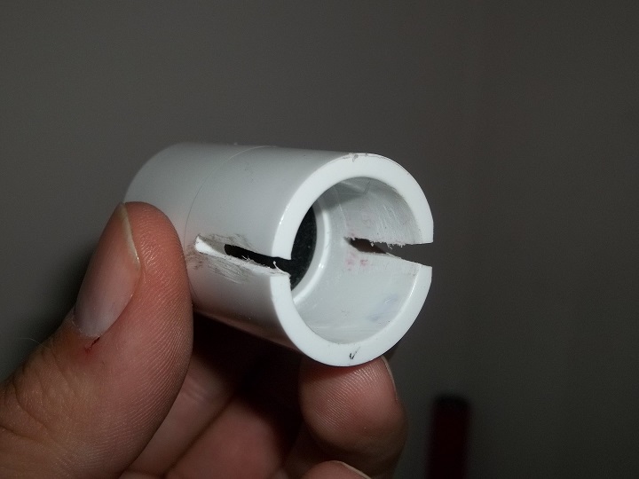

1. Using a rotary tool, cut two, centered 3/4-inch deep slots that are 180 deg. from each other in one
end of the 1/2-inch PVC coupler
2. Cut two more slots in the other end which are offset by 90-deg. from the opposite end (offset is to
preserve strength in the coupler. Otherwise the coupler would be nearly split in half)

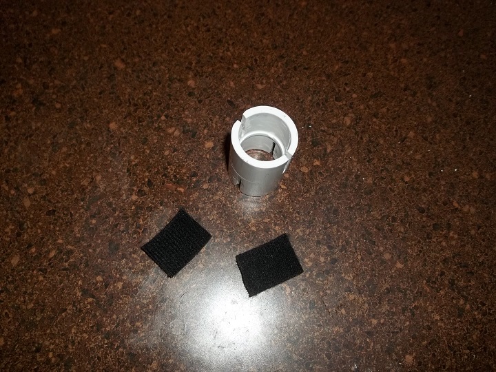

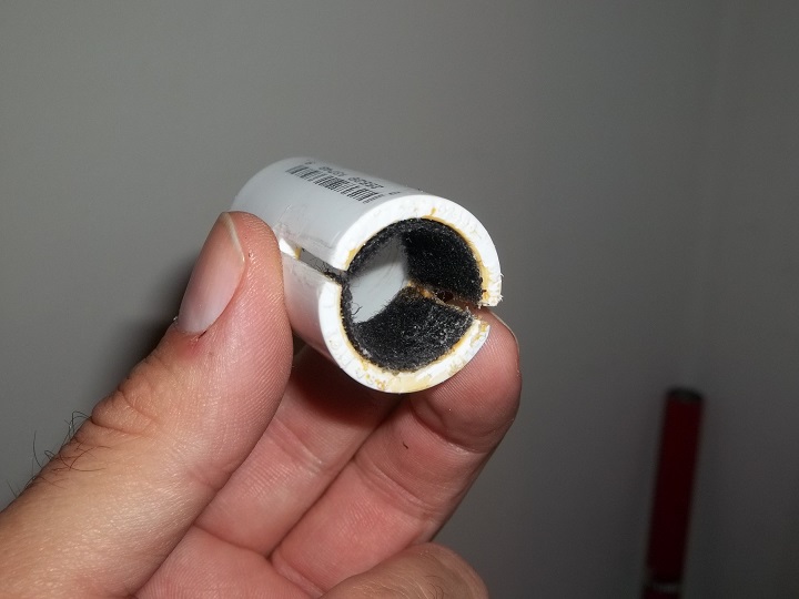

3. Since the Tesoro rod is a loose fit in the coupler, I cut pieces of 3/4-inch Velcro to match the ID of
the coupler and glued them inside. Other material could be used (maybe some rubber from an old tire
tube? - I don't have any). Regardless, the Velcro seems to provide perfect spacing to support the lower
rod.

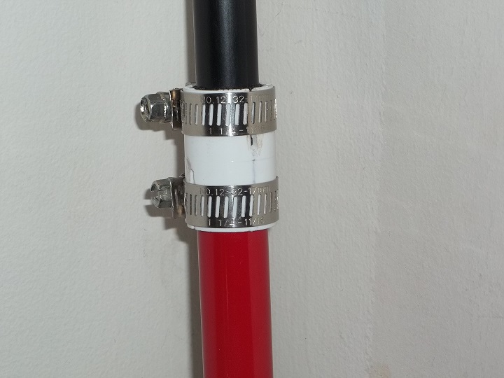

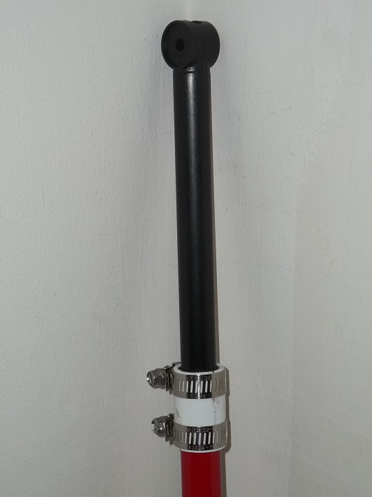

4. Install the coupler on the shaft using two 11/16 - 1 1/4 stainless-steel pipe clamps. (I trimmed the
excess steel off on the clamps on mine to make it look a little better)
I still need to drill holes in the upper shaft for the lower spring locks. Then it shouldn't look too bad after painting.
