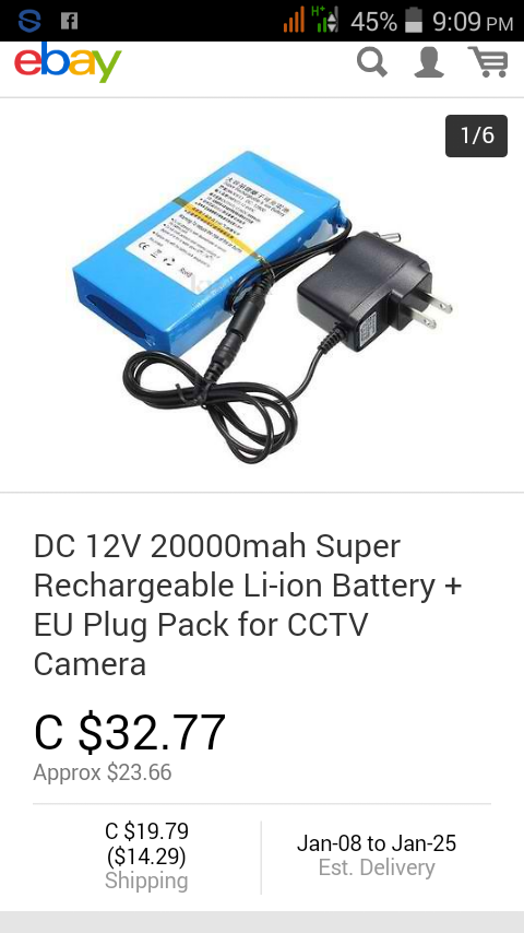

This seem to be a 3 cell in series battery (judging by the voltage variation in its specification) which is good. The most "energy banks" have some number of cells in parallel, and a switching DC-DC up-converter that is noisy and useless for detecting.
