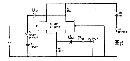

Measuring coil inductance and parasitic capacitance.
  • Measuring coil inductance and parasitic capacitance.
    When optimizing a PI it's necessary to know the coil's inductance and parasitic capacitance.
    This can be done with an extremely simple circuit and an oscilloscope (alternatively a Freq. meter).
    Full description: http://www.robkalmeijer.nl/techniek/...e48/index.html

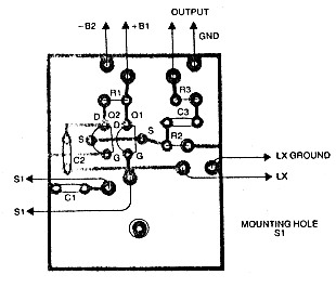

    PCB

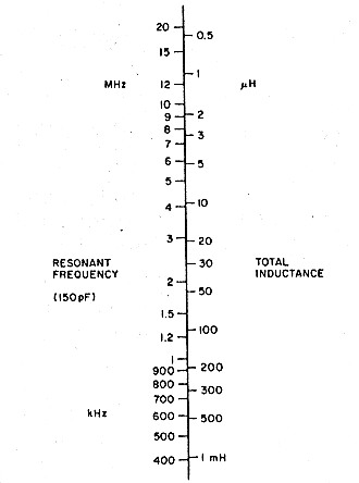

    Nomograph (for 150 pF)
    Partlist
    B1, 2 9V
    C1 150 pF 5%
    C2 33 pF
    C3 47 nF
    Q1, 2 2N5245
    R1 10 kΩ
    R2 470 Ω
    R3 1 kΩ
    Nice approach, I am using similar solution, applying some of applicable wide-band oscillator (in general wide-band X-tal testing oscillator can be simply adaptable for this purpose, by replacing X-tal with coil), but without additional fixed capacitor in tank circuit and without need for coded formula.
    So for measurement coil resonant frequency, we take real coil parasitic C and coil inductance.
    Those with FFT digital scope, can easily establish coil resonant frequency in Spectrum analyzer mode.
    Most PI coil will fall in 100kHz to 1Mhz range. No having scope we can build old known and simple multipurpose measurement means called Grid-Dip Meter (or nowadays Gate-Dip Metar).
    Then from coil inductance and measured coil own resonance, we can get coil parasitic capacitance using this nomograph (A, & B line here as example how to use nomograph):
    On paper printed Nomograph is not power depended and can be used everywhere, but in same way we can use some web coil resonance calculators as well.
      WM6
      What book was that nomograph copied from?
        Not sure about its primary source, rickb.
        I take it from old (former) YU magazine "Radioamater" and a little adapted to here more useful range.
        My present solution is with wide-band (easy start) oscillator integrated in out-of- module-made frequency meter (photo):
        After measured coil inductance (with L meter) and coil resonance with F-meter, we can get parasitic capacitance value in above Nomograph.

          I just noticed this thread from January of last year. I actually made and use that little circuit for coils too. Very handy and useful!
          Here's a little spreadsheet calculator I recently made in Excel for ease of use. Just plug-in your numbers in the "GREY" areas and voila! Makes the task quick for beginners or experts. The estimator at the bottom is pretty useless, but I included it just to mock-up the program that the author provided.

              Hello homefire,
              That certainly works also - for everyone that has a scope and a signal generator. As you probably know, many members here unfortunately do not have access to that equipment. The beauty of the circuit Teleno posted is that it requires neither a scope, nor signal generator. Only a cheap frequency counter as bare minimum ($10 or less from Ali? ...and the circuit, of course) is needed. A scope is optional. Simply connect your coil to the circuit and it oscillates. Then, after 2 frequency measurements (cap in-circuit / cap out-of-circuit), plug the 2 frequencies into the equations provided or use the spreadsheet I posted. Inductance, and distributed capacitance are calculated. The SRF is read directly from the f-counter (cap out-of-circuit).
              That's all. It's just a handy little 3-in-1 tool to provide some very useful info about our coils and no expensive equipment is required.

                Thanks for putting this nice simple method here! This is really handy. Can finally measure SRF and parasitic capacitance now.
                  Thought I'd reply to say I have built this and am really happy with the lovely little circuit.
                  Hope this may animate other rookies like myself who have not been able to measure SRF yet,
                  as they may not have a signal generator either.
                  In case you can't get the 2N5245 like me I have used BF245A as a replacement after doing a little datasheet reading.
                  Here a PDF of the original info for easy printing:
                  SRF_Measurement_N4TMI.pdf
                  And a picture of my build, so you know I really did it
