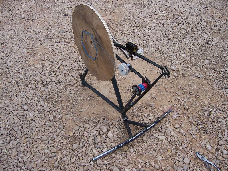

    Getting ready to try some VLF coil winding. Only 6 hooks shown, but use as many as needed to acquire shape. The board is 42cm/16.5 inch, so will make up to a 15 inch coil.

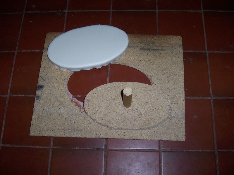

    I marked various size circles on the face for size reference. Wire spindle is clutched with a spring and large washer. Alignment bobbin made from the cutout piece from board centre, with pieces cut from a fridge shelf with a holesaw epoxied either side.

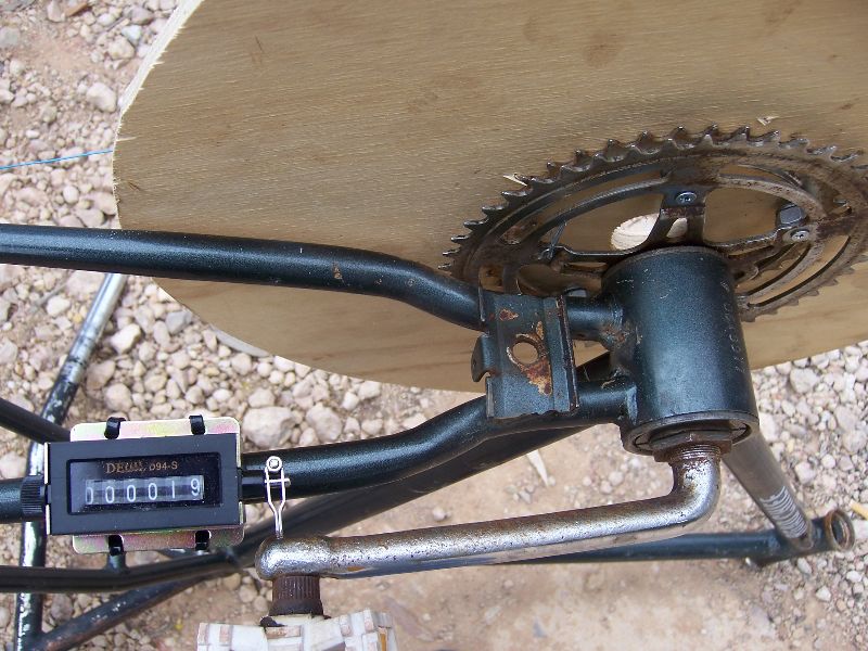

    Had to remove crank to take inner sprocket off- that's now part of the spacer for the winding board. Crank arm was cut off in-situ.
    Handle-bars clamped into seat bracket wit a tin spacer shim. Quite stable.
    $5 counter from fleabay, mounted with zip-ties, on rubber tube around frame to stop it slipping, but allow some movement and shock absorbtion. No more losing count of winds.
