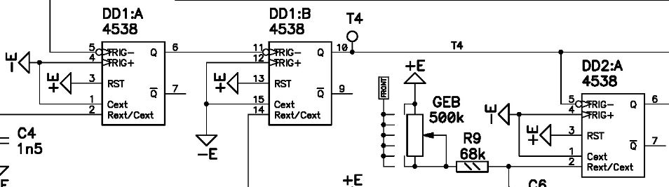

    Look at pin 13 and 16 of DD2 connected with each other and then connecting with pin 16 of DD1 on DP rev 5 board but this is not showing on your DP rev 5.0 schematic. So which one is correct? Click image for larger version
Name:	pin 16 and 13 etc.JPG
      yes, is not showing. and what? you think the layout uncorrect while there are 100th working DPs?

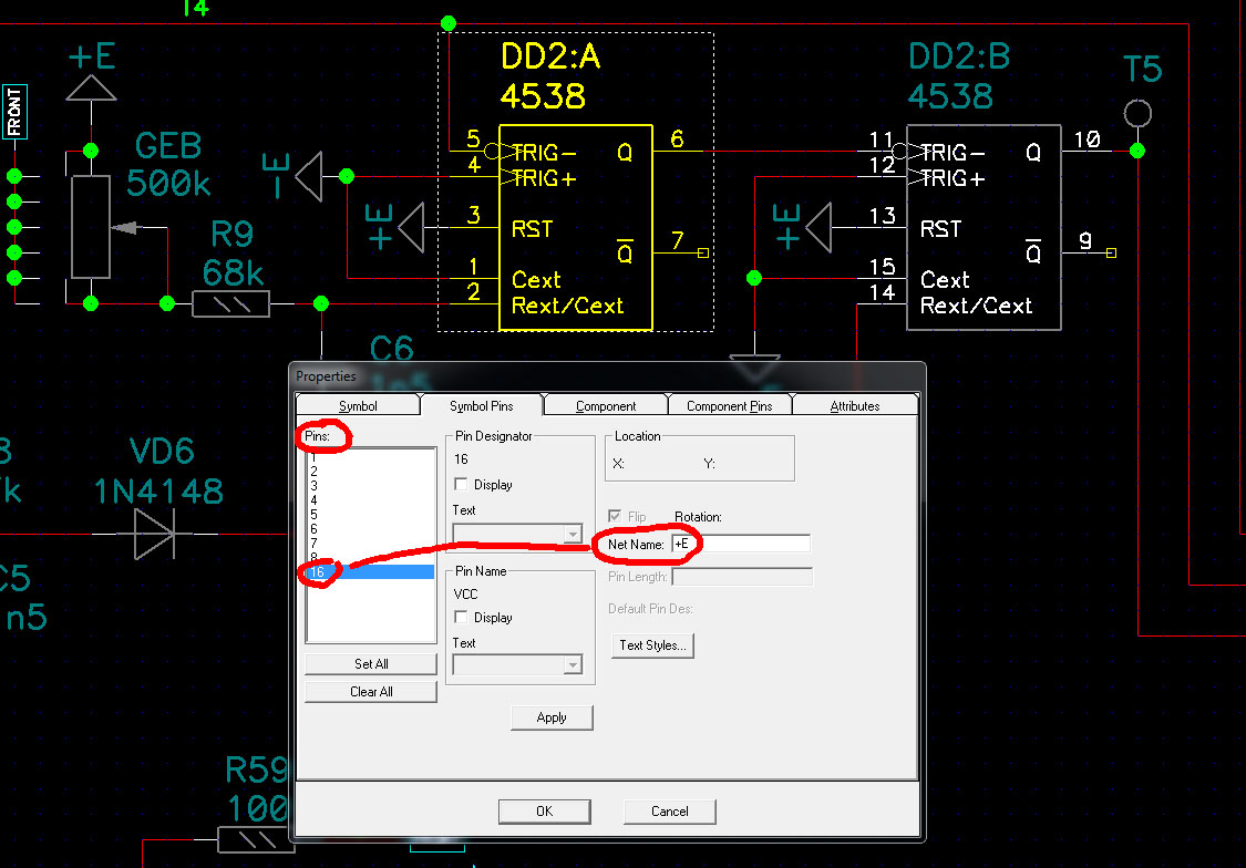

      you forget that P-CAD is advanced soft. i see you just try to find out fleas on my body where they are not.
      also for pin 8 that connected to Net -E.
          No flee hunting here. What you do with pins 7 and 9 of DD2?
            nothing. my schematic is sure copy of bulgarians one. you do not have to ask me about the pins. you waste your time to no purpose.
