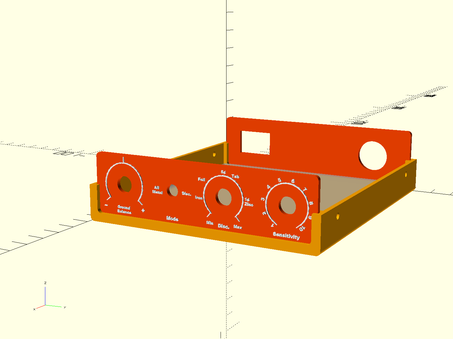

    Hey Everyone,
    I've been looking all around for a good box to use for the pcb and controls for my metal detector projects. So far I haven't been too happy with the choices that I found. I have access to a 3d printer at my local library so I was searching for boxes on thingiverse and came accross a bunch of different box makers but this custom box maker caught my eye since it lets you make holes for the potentiometers and switches on the faceplate and back plate.
    https://www.thingiverse.com/thing:2938921
    You will need to download an open source cad program called Openscad, and it must be the newest development snapshot for it to work: http://www.openscad.org/downloads.html#snapshots
    I attached a box I've been building for my TGSL, its still a work in progress such as the markings for the Discrimination(iron, foil, tabs, etc) might not be in the actual correct location on my discrimination potentiometer. The colors are also adjustable but these colors made it easy to see what changes I was making.
    Hope this helps someone out there!
    TGSL_Box.zip

      I 3d print all my Metal detectors encloses, I also 3d print a built in battery packs, which is what I use for the TGSL, the only thing is you need to do is, ground plane the inside, I use one of two methods that seem to work well, 1.) you can use super77 3M adhesive and spray one side of Kitchen aluminum foil and lace the inside of your box with and put a piece of wire to connect to ground, 2.) Use Copper tape,( cheap roles on Amazon, its longer to do then the foil but works great in the corners. Looking at the jpg of your box, unless you use a 0.25 nozzle, a FDM printer will have a hard time printing out the lettering of your box, I save my self built time by making a face plate sticker for the fronts.

        Thanks for the advice regarding the ground plane I wasn't even thinking that it would need it. Would aluminum tape work as well? Such as this https://www.amazon.com/Aluminum-Tape.../dp/B01FROBUXE just asking cause I think I have some of this already.
        I have no idea what size nozzle my library uses but you're right it would be better to just design a face plate sticker, that way if my control lettering/design need adjusting I could just reprint a new sticker and put it on top of the old one.

          This is a good idea, make the front and back panel from single side PCB, line the box with copper foil tape , solder a couple of wires and bingo all done

            The problem I found with aluminum tape is, the sticky(the adhesive ) part is not conductive unlike copper tape which it is. if you want to use the tape you have, you will have to make a physical connection to each tape you lay down.
              Got it, I'll buy some copper tape!
