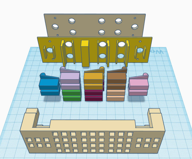

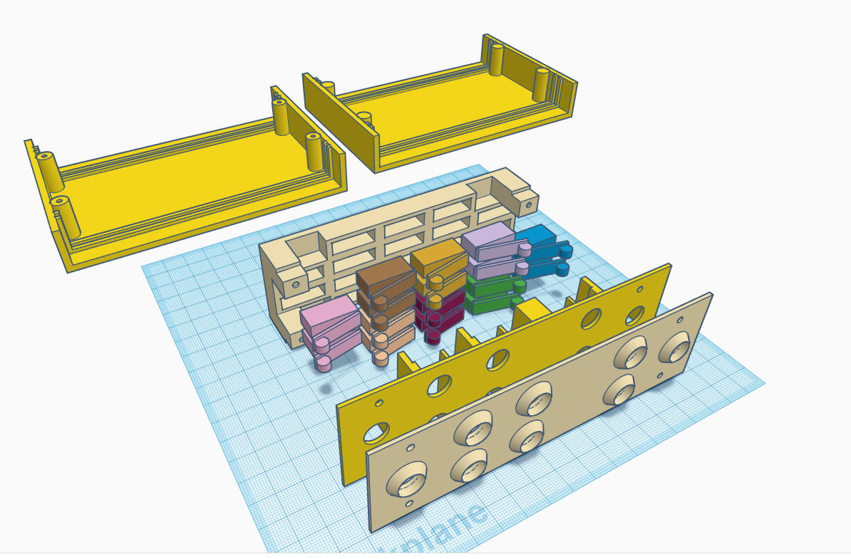

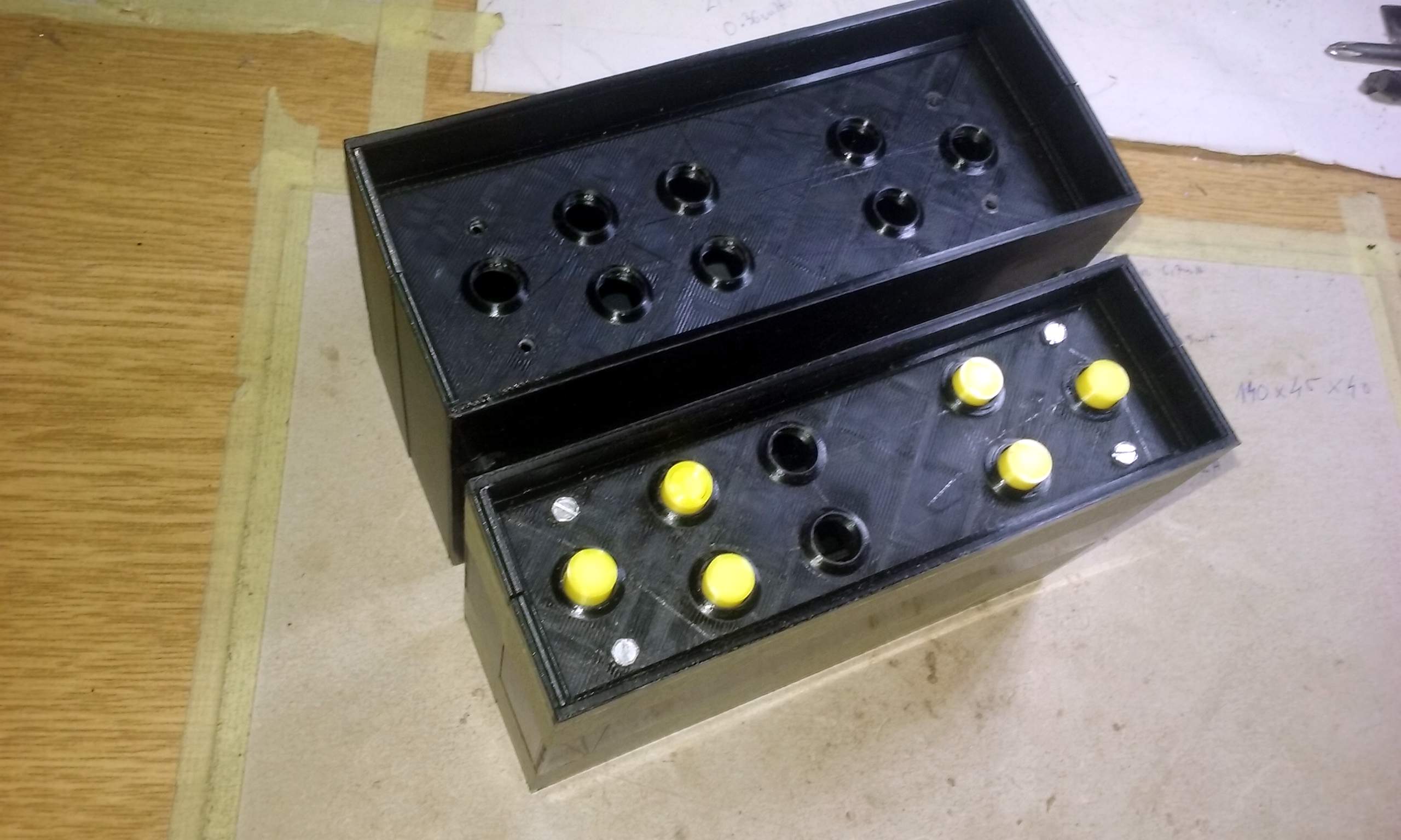

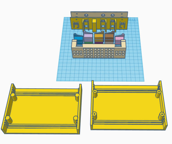

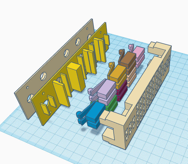

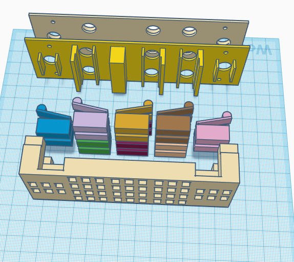

So i came up with different solution. Micro switches with lever and 3 poles. Very durable.
Even that is not enough, so i put 2 of those per one button. If somehow one fails; second one will not.
Also the "mechanics" is done such way to prevent any uncontrolled hard pressing. Pressing is "soften" and amortized by the mechanical limitations.
There is almost none resistance to the press. But one can not hard press the button and apply any redundant force on it.
This should be now "eternal" commutator for the remote control.
First i made one larger, bulky. Than i refined it and made it more compact (last photo).
3D printing is a mighty stuff! Can solve many problems.
