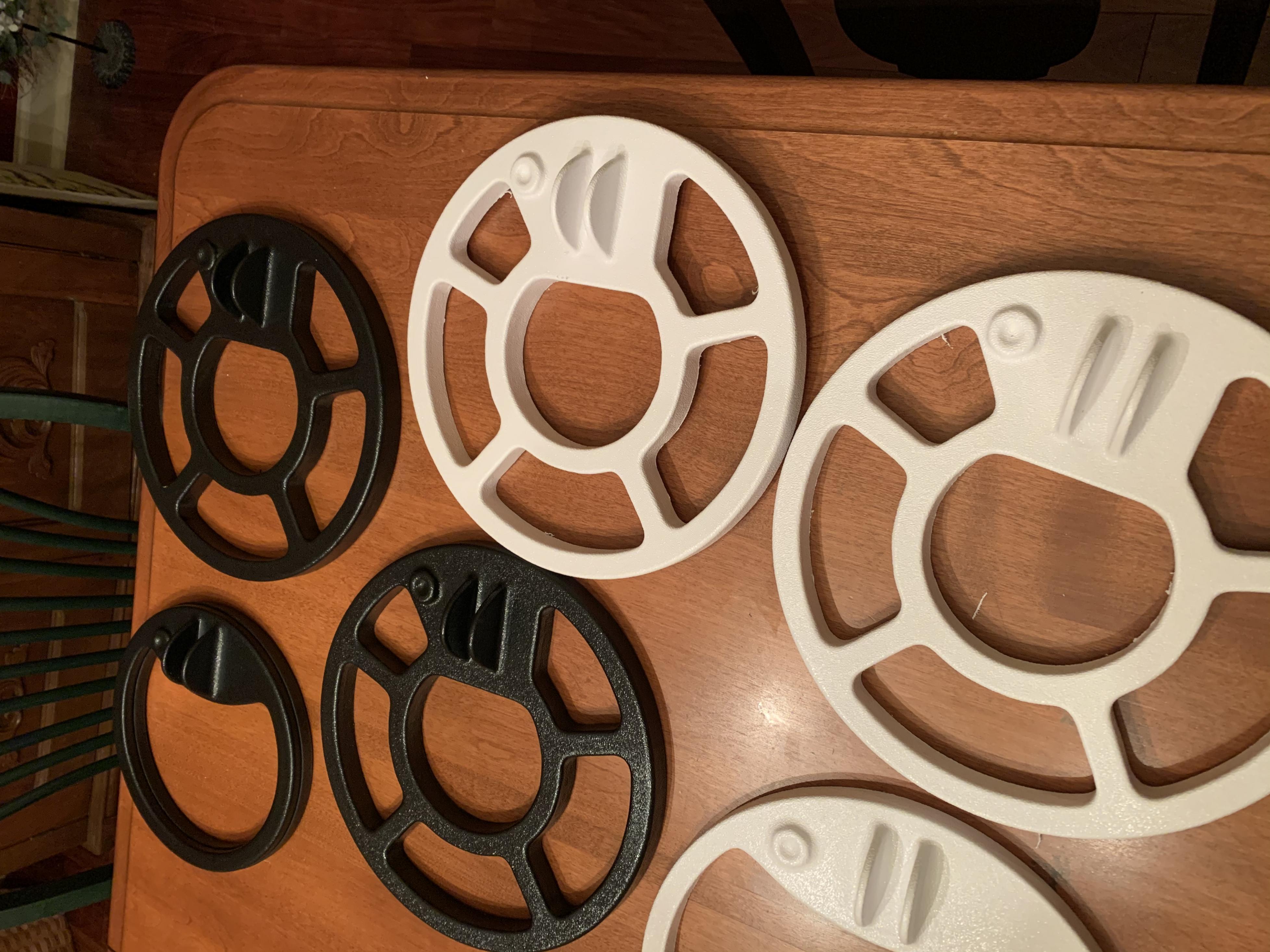

            Nice looking coils Don, have you started making anything in the ten to twelve inch yet? besides the White concentric

                  Hi. I don?t have any drawings of the concentric. I was just playing around with a router and circle cutting jig. I have a 10 and 11? form so far that is loosely based on the Troy X5 9? concentric. I?m not sure how to effectively shield these coils but may try conductive paint. It will most likely get used for the Voodoo project.
                  I can send some off if anyone is interested. No covers available yet..
