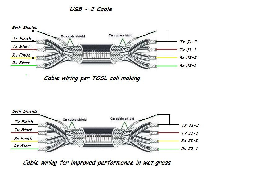

                  • #54
                    Don,
                    7. Cable – Type will depend upon what your project specifies. I use a USB – 2 cable for my TGSL coils
                    In a standard USB cable there are 2 thick wires for the 5V power supply and 2 differential signal wires.
                    How do you connect the 2 coils in a double D configuration ?
                    Use the 2 power wires for one coil and the signal wires for the other?
                    Best regards,
                    - Bernard
                    • #55
                      Originally posted by F117 View Post
                      Don,
                      Best regards,
                      - Bernard
                      Yes, the USB cable seems to work just fine for the TGSL projects. A better choice may be Belden - M 8723 depending on what project you are building, but is basically the same thing with individually shielded pairs. The bottom image is what I prefer:
