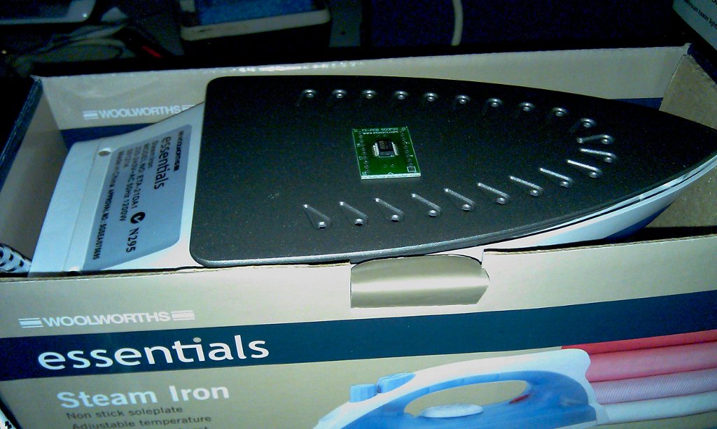

    Below is the SMT work surface ....

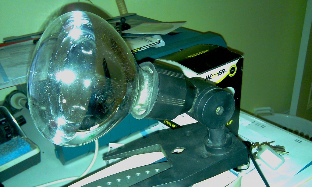

    Below is the Reflow booster ( ie IR lamp )

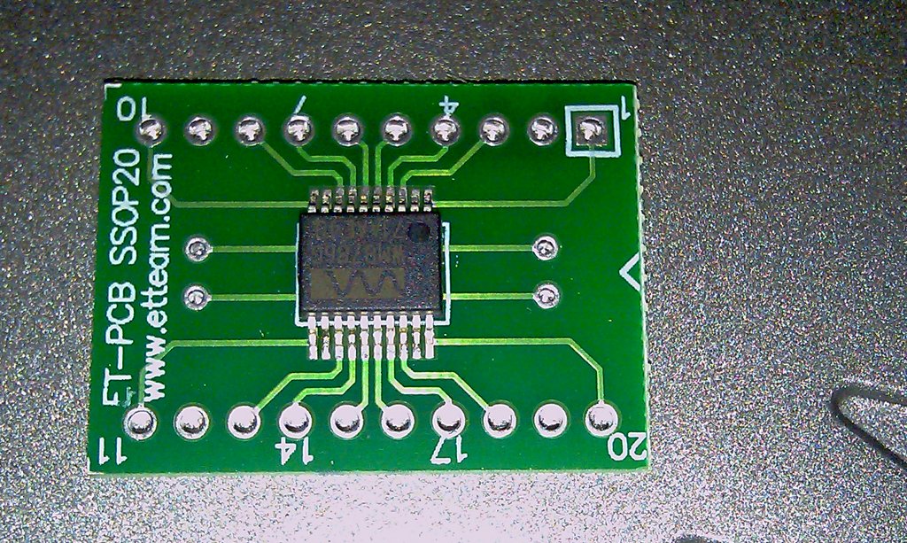

    Below is cooked board.

    1. Turn IRON heat setting to MAX .
    2. Mount IRON so flat bottom is level ( I just use it upside down in the box it came in )
    3. Turn iron on.
    4. Allow iron to reach stable heat ( approx 2 - 5 minutes )
    5. Apply solder paste and position components on PCB ( maybe you did this already )
    6. Place PCB on hot iron surface ( component side upmost )
    7. Wait 20 to 30 seconds for board to heat ( this will vary with size of board etc )
    8. Turn on heat lamp about 10 cm above iron surface / PCB & components. May be fix mounted or hand held.
    7. Should see solder paste reach liquidus ( ie melt ) in about 10 to 20 seconds.
    8. When all joints have reflowed ( move the light around a bit if necessary ) turn light off
    9. Wait further 10 seconds then slide board off hot plate carefully or just turn the iron off and cool with slight airflow.
    10. Your done !
    TIP use a pair of sunglasses when light is on ( it is only Infrared light however it is a bit blinding in a dark workshop ).

            I use a similar method. I got a electric skillet from Wallymart, $19.95. It works great and no need to use an IR lamp. I got the idea from a Sparkfun tutorial.
            http://www.sparkfun.com/commerce/tut...utorials_id=59
            I also have found that with care you can do same board more than one time. Example, apply your solder and place the caps and resistors, reflow these only. After the board cools repeat with the IC's, transistors etc. This way you can manage the fine pitch parts placement and not worry about a bunch of resistors and caps.
            It seems to me the most important step is applying the solder to the pads. Too little no connection, too much you get bridging and tumbstones. Overall, this is a great method, and beats hand soldering and even expensive reflow ovens for most small jobs.

                  Have stuck larger components to board with tiny!! drop of superglue to get the most number of components on the board before placing on the iron. I do not like heating parts too many times and it keeps them in place while adding others. Less chance of mis-alignment.
