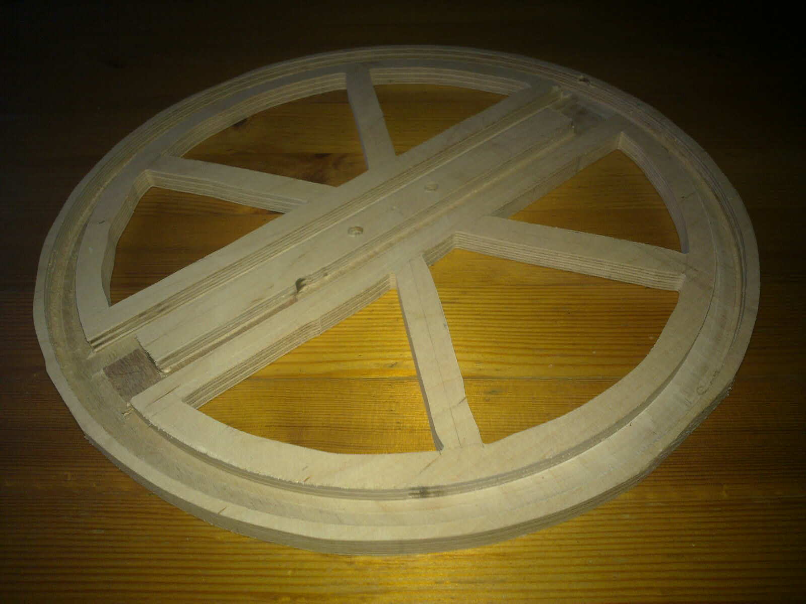

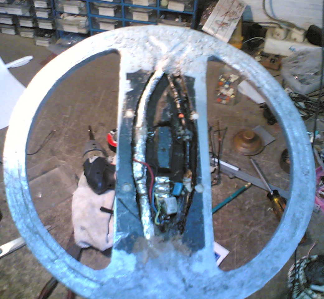

    Having no access to vacuum forming equipment, I tried making the housing of styrofoam. That's quite rigid and light. When pouring in the epoxy, I found the reason why it is not widely used: it melts.
    I took a piece of 9mm thick plywood and made the housing with jigsaw and router. The slot around the circumference should be snug fit, ie it would not need apoxy at all, just few drops of glue to prevent the coil from popping out.
    The overlapping part needs some glue as well, as it is not possible to route the slots exactly at correct nulling.
    My goal is not to use epoxy, as the brand I used, seems to get hot and expand a bit thus changing the phase shift.
    This coil housing is made for TGSL. As it's the first prototype, it's of coarse made. If it works, the final housing will be sanded, polished, painted, decorated and scented.
    I intend to glue the coils in place and then cover the whole with several layers of varnish.
    The housing weigths 155 grams. The coils are 80 grams together. I guess it stays well under 300 grams finished.
    Any experience on plywood housings?
    Excellent job! I don't have router but wanted to do exactly same idea. Actually I wanted to wind the wire on the plywood, but then it really has to be exact because no ability to shift for null!
    The problem may be the weight. But it should be sturdy enough. You can always experiment with removing more and more wood. dfbowers coil weighs about 425 grams. My resin coil weighs about 475 grams. So maybe you're OK.
    I am amazed that epoxy curing causes so much phase shift. I'll believe it. I'm not sure it matters too much.
    I am thinking of gluing coils directly to thin piece of paneling wood, no routing at all. Maybe use clay to make mold and pour some resin. Not so pretty, but easy???
    Anyway, keep trying. I want to know how it works out.

      Be careful what you decide to paint it with! Epoxy is ok but if you get it "wet" with any kind of paint at all it might warp. I was horrified once when I tried to paint one and it destroyed the null. One thought:
      You are on your way to making a vacuum form!! That's where I started before I decided to make a coil shell from a wooden coil.

                        been able to get a professional finish like deflowers which looks like one you would buy from a manufacure, credit to him.
                        (You may have credited dfbowers with some extra attributes he wouldn't lay claim to...)
                        There are artisans here who can really make fine models that I don't dare to dream of, dfbowers one of the best!
                        In the spirit of low-tech do-it-yourself I like to experiment with off-the-shelf techniques you can find in your local hardware (grocery, etc.) store, although most of my ideas are huge messes. I think it is worth coming up with really easy, if ugly, construction techniques for any enthusiasts who want to build an MD but simply don't have the time to develop the craftsmanship to build a professional looking machine. The idea is to go for pure function, not fashion.
                        So I'm interested in what you find out with balsa wood and other techniques. Lead molds sound pretty tricky to me, and not something anyone else could easily do, but if you can achieve it, maybe it works for you.
                        I have wondered if the light foam material that is used for model airplane wings would make a good base to glue our coils to -- strong and rigid, but light.
                        It is very important that the coil housing be rigid I think, because flexing and vibrations can probably create large signals.
                        Those other materials you mentioned may be very good -- I hope you try them and let us know how they work. However, you really need a good, working MD to use them with and a well-built coil for comparison. I am lucky that dfbowers sent me one of his excellent models, and it is invaluable for comparing and trying different circuits, coils, etc.
                        Keep trying stuff and take photos. I think you have the right kind of crazy to succeed!
                          If you kept the coil size down it'd probably work, expanded polypropylene foam as used in slope gliders would be the one to try. Especially the weightier denser grades if you can source them. To increase rigidity/durability and keep the dirt off you can use regular A4 laminating film heated on with a regular iron. It's a bit tricky so practice on some of your offcuts first but with some careful use of scissors and a bit of pre planning it can be done quite nicely. I've used this technique on slope planes before and obviously the last thing i want is wings warping, with care and the right temp it can be avoided fairly easily.
                          If you need to glue any parts, you'll probably need to use a polyurethane based glue (Gorilla Glue if you can get it, Vise Grip is a similar product here in Aussie land), they expand as they cure which'll require a bit of cleaning up after (tape over the areas you've filled with glue and tape down the separate foam parts) but the joints are as tough as the EPP afterwards. Epoxy could be worth experimenting with, but I'm not sure if it'll have the same longevity, CA glues will also work, though some will eat the foam and again I'd be a bit suspicious of the durability.
                          We need a dedicated Experiments in coil housings thread, where everything from bucket bottoms to wood fab to frisbees can be discussed.

                            Wooden coil housing, despite nice looking, electrically not realy apropriate solution (moisture-hygroscopic, dimensional instability, wood act as soil, weight).
                              I tried once From 9mm thickness MDF.
