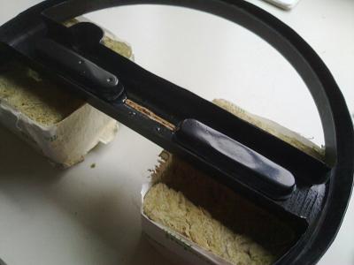

    Casting DD coils into epoxy takes quite a lot of expensive mass and makes the search head heavy.
    When vacuum forming the coil shell, one can place 2 “fingers” in the middle of the D’s. When finished, they are cut off, glued to the bottom of the shell, in the middle of the overlapping section. The coils are then added, nulled, glued and finally cast in epoxy. This particular shell saved 30 cubic centimeters epoxy, which makes approximately 50 grams less weight.
    That is a twist that I had not thought of. I have been cutting light weight quarter inch thick paneling to fill the void spaces in the shell. Will have to give that a try.

      Great idea! I almost had a coil failure last night. I did a pour of epoxy for my Barracuda project and I added some foam blocks.. Well about 2 hours into the curing process one of the blocks (that I used for filler) broke free from the adhesive and floated to the top.. Yikes!! What a mess. I was able to salvage everything with just a few bubbles on the top. If you use a fillers make sure that they are secure!

                  Good idea, how does it affect the rigidity of the finished coil?
                    Not too much, I think. There's three wide connections left between the halves anyway. I'll report here when I broke mine in use.
