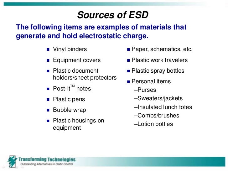

also Keith inportant knowledge. protect the board against electrostatic discharge. remember - on your body, hands,
ALWAYS IS ELECTROSTATIC CHARGE. so if you want to take the pcb take for MINUS or PLUS power supply tracks.
close all pots by one naked wire and connect this wire to especial point on board,
take just for this wire at first.
just read https://en.wikipedia.org/wiki/Electrostatic_discharge
i do not want open new thread on the subject because my english is zeroed.
follow this simple rule. CMOS chips is afraid the HV ESF discharge onto the way 'your hands <---> CMOS pins'.
