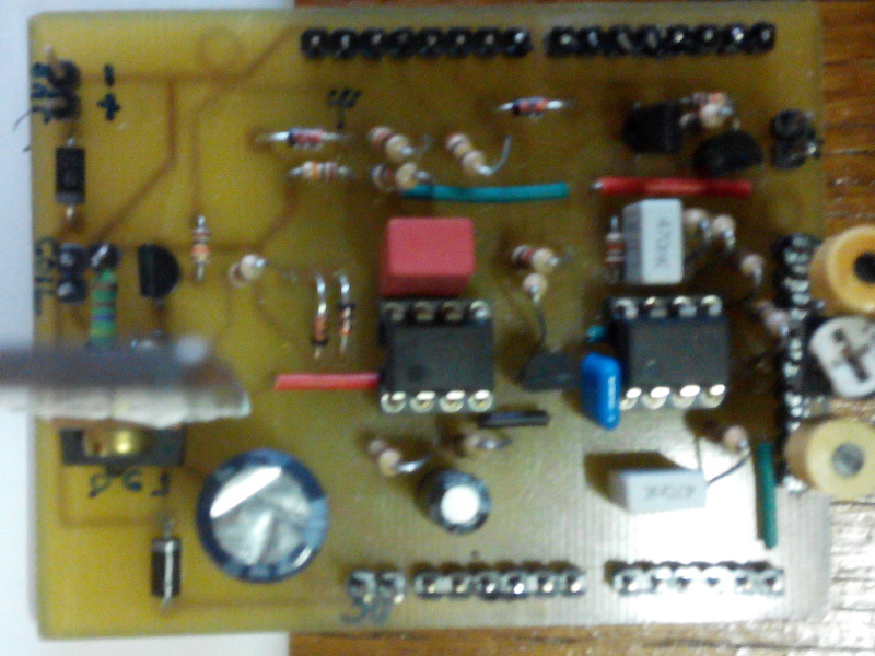

                            yes, I designed a shield for it. See attached pic. But of course I cannot give away the PCB design, people would be able to trace the schematic from it.

                              cool, a nice board
                              right size

                                Now working on this metal detector and almost done.
                                https://www.dropbox.com/s/sas6m6y9t2...board.jpg?dl=0
                                I have some issues:
                                1. If I use 12v battery or bigger and make separate 5v power supply for arduino will it burn?
                                2. I would prefer rotary encoder implemented to arduino as it is more precise than pot. There is code, will it not mess timers?
