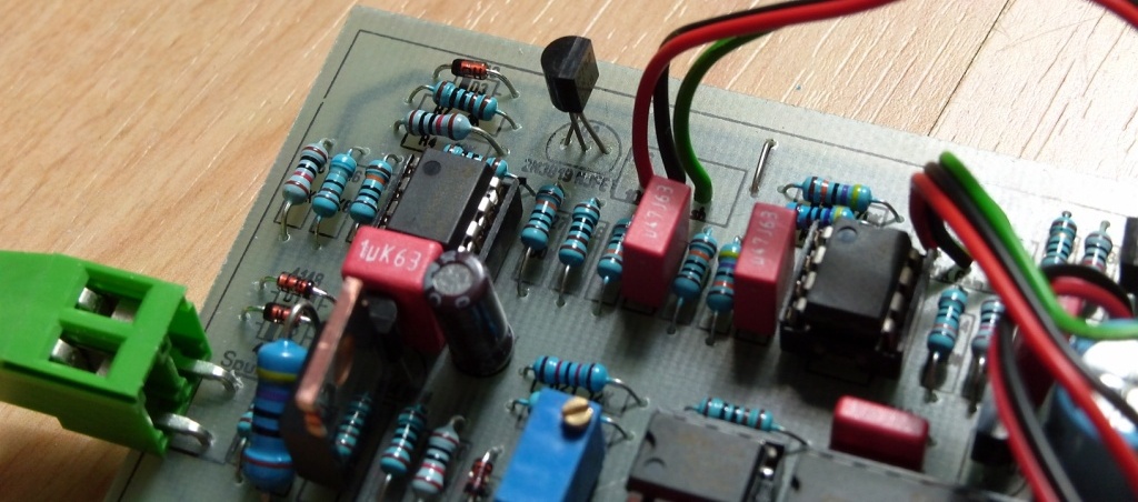

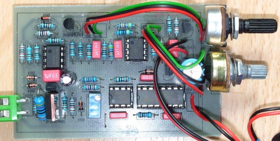

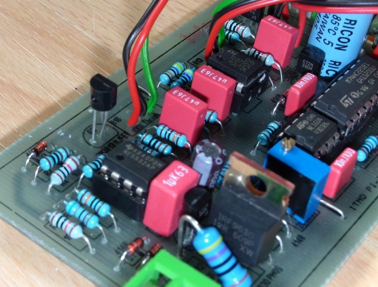

              finished soldering yesterday, and broke my brain by soldering the q3 2N3819 corrected
              would be better to use a mpf102 and reverse it 180 degree
              i can adjust a light humming sound without the coil connected, if i connect the coil the irf9630 get hot and i got no detection
              so i thing i should check the ic4a 74HC221, at the monet i have used original layout like in the book but only q3 changed like in errata list
                maybe this helps

                    ok i will try 8*1,2V for power supply on my pi-1, but i think i have still Problems with the irf9630 which gets hot in 10sec
                    or my 2n3819 is still wrong can i use also a mpf102 or is this totallywrong for that Project, 2n3819 is out of production and not a cheap part
                      Make sure you get the pins correct.
