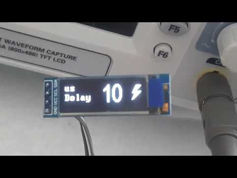

                Version 1.0.3
                ArduinoPI_fullPWM_1_0_3.zip
                Changes in 1.0.3:
                - Pot reading validated against adaptive hysteresis thresholds before being accepted (+- 8 bit noise).​
                  Nice....... erm life would be so much easier with an encoder
                  Toggle power with the encoder button and set delay with the encoder. I've plans to show the TX power in the bottom left of the oled.

                    Version 1.0.4
                    Changes in 1.0.4:
                    - TX Boost icon added to the FontLargeDigits.h file.Code for displaying it on switch changes.​
                    ArduinoPI_fullPWM_1_0_4.zip
                        For those willing to try the LGT8F328P based Nano there are two Arduino cores you can install:
