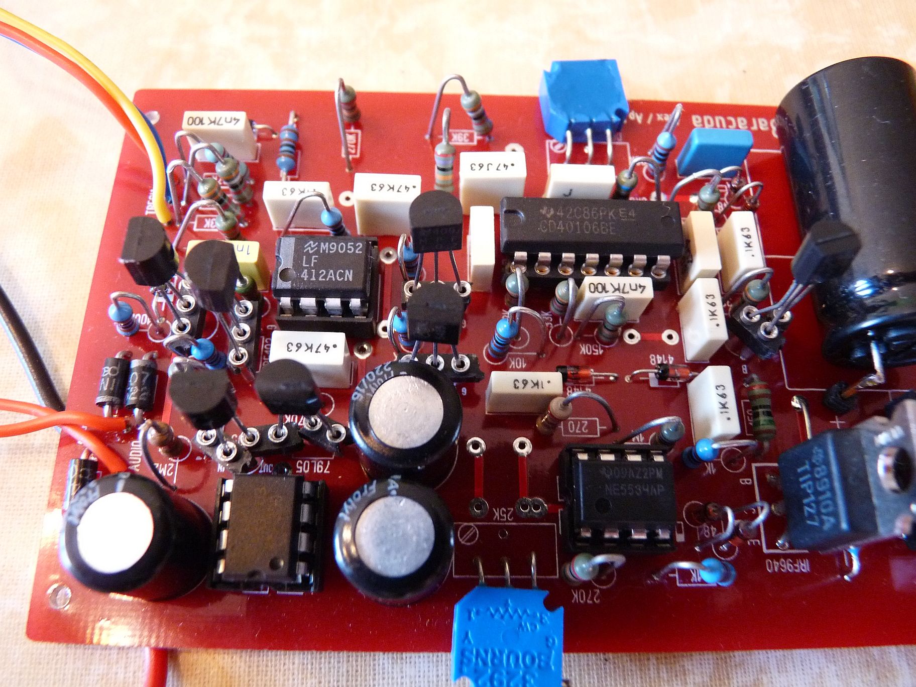

    Thought I'd share. I am excited about this and have not been active in electronics for 20 years. I realise I am enjoying this
    I will be making three quick and rough coils tonite for testing and take it from there ...

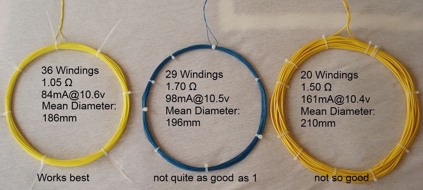

    Here are my three quick and rough test coils for the Baracuda: Click image for larger version

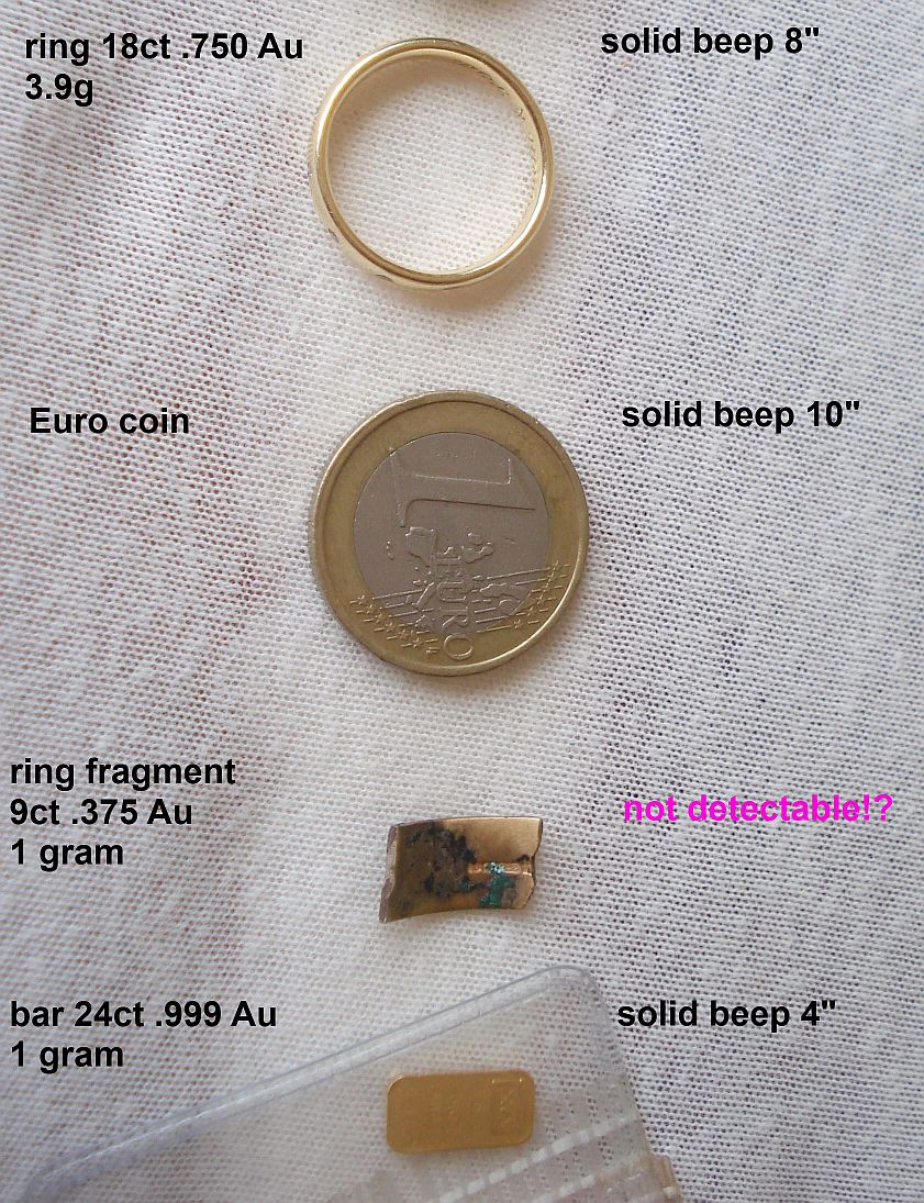

    These are my results from an air test. The ring fragment non-detection has me wondering. Any ideas? Click image for larger version
    Problems I ran into with my build:
    - I was powering the Baracuda between 9.6 and 12 volts at 1.2v increments. At lower voltages the Baracuda would work fine
    for a few minutes and would then beep every 10-20 seconds. I measured that the 7660 chip was only putting out a few -volts.
    I tried the five different 7660's I received from Silverdog and had the same results. I thought I had a batch of bad chips at
    first, but didn't want to give up and had a close look at the 7660 spec sheets as all the soldering and input voltage was fine.
    What I did not understand is, what function pin 7 (osc.) has in the Baracuda circuit. It looks like it is an input pin but not an output pin?
    Having a 2M2 resistor connected to it baffles me too, not much of a signal is going to get through. Any ideas on this?
    I would like to see what is going on with pin 7, but I don't have an oscilloscope.
    So I just disconnected pin 7 osc. and tested the Baracuda again. My negative rail -5V was working stable all the way down to 7.5V battery voltage now.

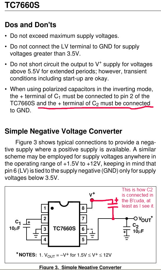

    Here is what I also found when reading the spec. sheets:
    When using polarized capacitors in the inverting mode,
    the + terminal of C 1 must be connected to pin 2 of the
    TC7660S and the + terminal of C 2 must be connected
    to GND.
    It looks like C2 in the Baracuda PCB I received is not correctly routed according to the data sheet of the 7660!

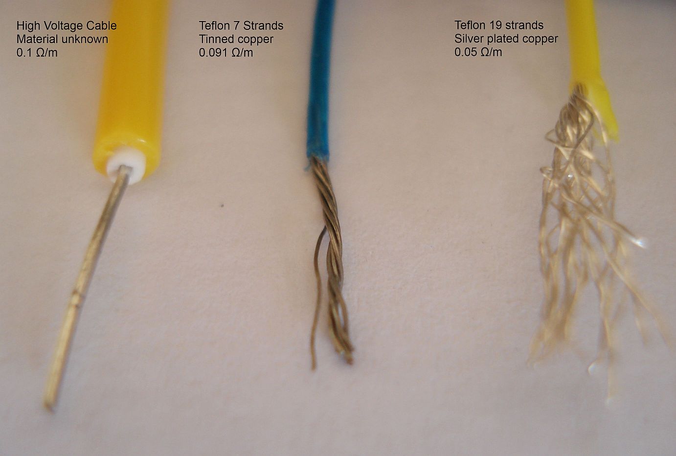

          Hello Porkluvr,
          I live on an island in the Med. Sea. Can't get much stuff here and ordering stuff through the internet often incurs huge shipping costs. So I build up a shopping list which goes to my parents or friends. When I visit or they visit anything I've ordered comes along.
          I traveled to Germany in July and had my latest shopping list with me for building the Baracuda not knowing where to get the stuff.
          Here goes my story of how I got my coil wires:
          I was on my way through some small back country towns in Bavaria in the car with relatives taking me out to some beer garden. In one of these towns I saw a wall of little plastic drawers you keep components in through a shop window. I asked my uncle to stop and let me out. I went in this shop and felt like I had time traveled. There was a friendly old man inside.
          I was thrilled. I showed him my list and remarked that I didn't think places like this existed anymore. He said his shop wouldn't be around for much longer as hardly anyone builds things themselves these days and he would be quitting in September sometime. We didn't talk much after that. He hearing was not well, he was fetching parts and my relatives were getting impatient.
          They had no idea what a treasure trove this was, I could have spent a lot more time there. Whilst he was fetching parts from the list I had a look at the wire rolls on the side wall. I saw what looked and felt like teflon wire and bought 30meters of each. I asked for the specs and he told me that is a surplus from a company that had it custom made many years ago and he had no information on it. There were no labels on the rolls.
          Fast forward. I built the 3 different coils and tried them and was happy with that.
          I wanted more of that wire and in the meantime found out that finding teflon wire
          on the internet is not an easy a task as I thought it would be. I called my uncle and asked him
          him to go find that shop again and get me 100meters of the blue and yellow teflon wire and to
          send it to a friend who would be flying in soon.
          My uncle told me the old man in the shop has no internet site and doesn't use a phone.
          As far as I understood him, he opens shop when he feels like it.
          I wasn't aware that teflon wire is relatively hard to get.
          If it's worth getting the teflon wire I will beg my uncle to go get the rest he has.
          The sooner I know the better. September is coming.
          So please give me input on this.

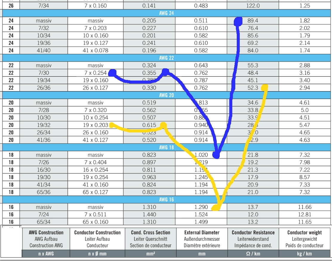

          I have measured the specs of this wire myself and tried to find it on an AWG list,
          but it didn't correlate. So I have marked the parts that match.
          Perhaps this is of interest to you. Can you explain it to me?

              I believe you were mistaken when you suggested that an ICL7660 datasheet shows the capacitor (-) going to ground in the inverting mode. Please look again, it should be between pins 2 and 4.
              But I do believe the PCB circuit is inadequately bypassed (not enough large capacitors in the right places). Please look in the last few pages of the Barracuda thread (or Baracuda, whatever the spelling), I believe the problem was addressed.

              I believe your blue wire is around 24.5AWG. If you want to be sure of what you have you could measure the bare wire diameter with a caliper then compare it to a wire gauge chart. It is a little tricky to measure stranded wire accurately, but it can be done. Don't squeeze too hard.
              GOOGLE search engine will find you lots of wire charts.
              You'll need more than one because not any of them will have everything you might want to know.
              I hope you have a PC or other machine with a large screen because a wire chart can be challenging to digest.

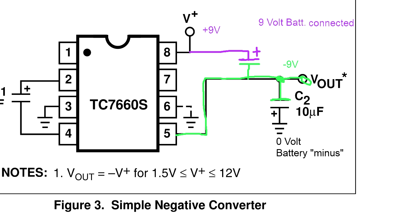

                Hmmm, I did re-check 4 different data sheets and looked at the Silverdog & original Anchor pcb pictures.They appear to have the same "problem".
                I do agree with you as to C1 polarity between pin 2 & 4 of the 7660. What's bugging me is C2. Here's a screenshot from one of the data sheets.
                I hope it helps clarify this. The red drawing and text is from me.
                  A single strand has around 0.25mm diameter and the whole bunch of 7 strands around 0.6mm diameter. Measured resistance at 100 meters is 9.4 Ω.

                    Do not worry about that. V+ and V- will appear the same (AC) potential to the capacitor in question. (Just make sure the (+/-) terminals face the right directions.)
                    edit: Please make sure you use high quality capacitors; low ESR, not surplus unknowns.

                        DING DING DING - I got it ! Both ways work, except that you need a capacitor with a higher voltage rating when done the "baracuda way".
                        I would believe that lower voltage caps are cheaper/smaller, so why do it like they did? Easier routing, happened by chance or something I can't fathom yet?
                        Thanks for helping me "get" this! Here's the pic I drew to help get my brain round this:

                              Porkluvr, I am glad you didn't want any of the blue 7 Stranded tinned wire.
                              Why? I just found out that it is NOT Teflon insulated, the yellow one IS.
                              It's PVC . I would have been very ashamed. So if I do run across tinned teflon wire
                              I now know to buy it all ...
                              Reading zillions of posts here I came to the awareness of the importance of Dielectric
                              Values especially in PI design. So I got the necessary infos to classify plastics.
                              I did some flame tests and now I know.
                              What wire would be better in your opinion for a PI used only in sea-water
                              (3.6-3.8% salinity), would it actually make a difference? Exceptionally fast delay times are
                              not needed here as far as I have learnt from this great website and contributors.
                              Here are the final specs of the two wires:
                              Color Conductors Insulation/mm Diameter Ω/km Finish
                              Blue 7x0.254 PVC 0.125 1.0mm 92 Tinned copper
                              Yellow 19x0.203 Teflon 0.205 1.35mm 51 Silver pl. copper
                              Thank You! Polymer
