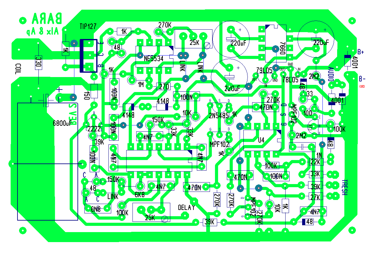

        a history was I got PCB pics from Alexismex with huge difficulties. but got. what I see there. Alex did not upsolder the components
        and did not measure them. that is the problem the information is not so full as we all waiting in it. its real problem.
        as I many times wrote SAT part was deleted too from new release of the board. you have to measure 1000 times and only 1 time to cut the cloth.
        but nobody does such way - taken crude schematic and fully confident all are OK, as the result is bad unstability abnormal function.

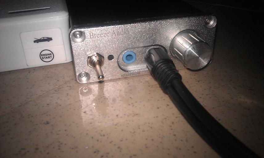

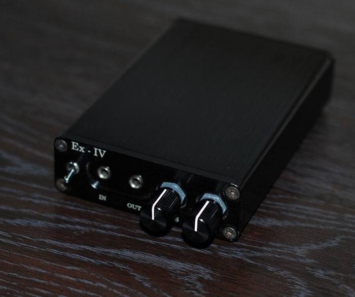

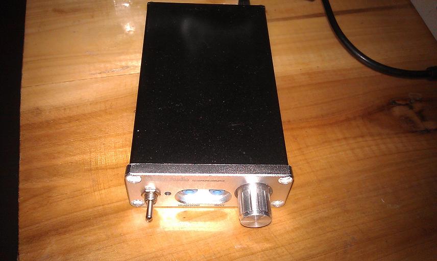

                  At first, need a shell for circuit board.
                  I would like to order a headphone amplifier shell,
                  like this Click image for larger version
                  but the shell is made of aluminum alloy, I don't know whether it make interference?
                    Originally posted by skylly View Post
                    I have free time now. and want to test my detector outside.
                    like this [ATTACH=CONFIG]31910[/ATTACH]

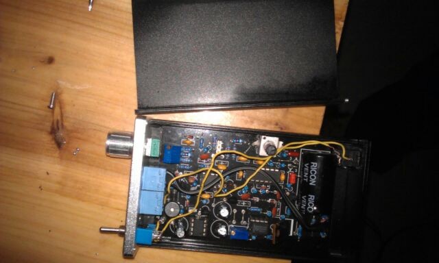

                    The shield of a metal box is better than a plastic box. Just make sure there enough room for the big capacitor and clearance underneath to avoid a short.
                      Also make sure anything tied to the case is really ground as many PI circuits are "upside Down".
                        After waiting for a few days, Finally got my box,

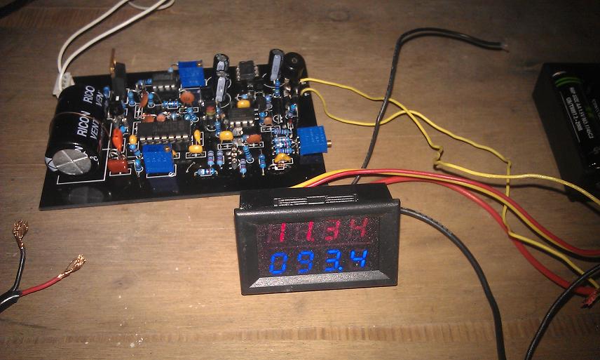

                          more picture here:

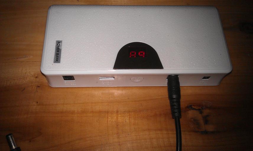

                          power suply: a moveable power with 12v output.

                          the front panel.

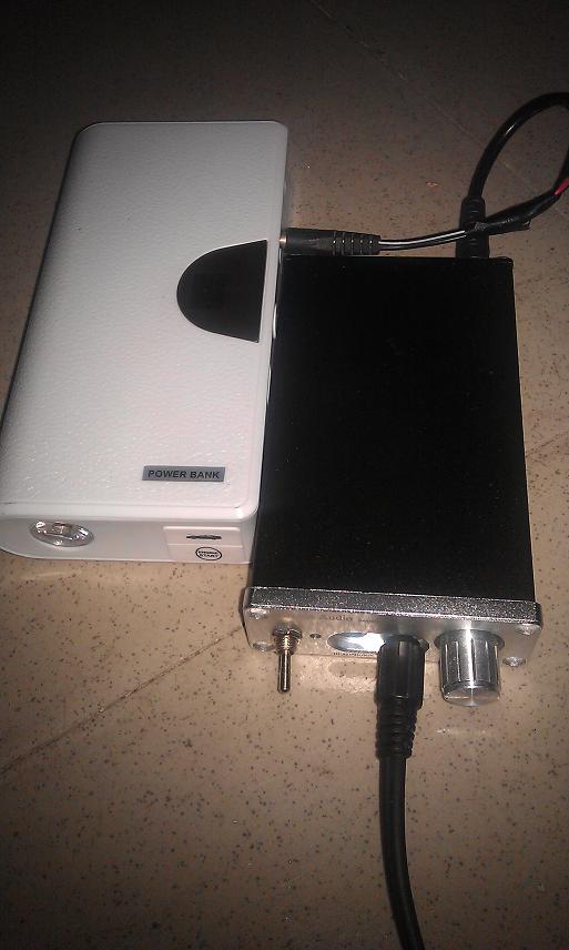

                          together:

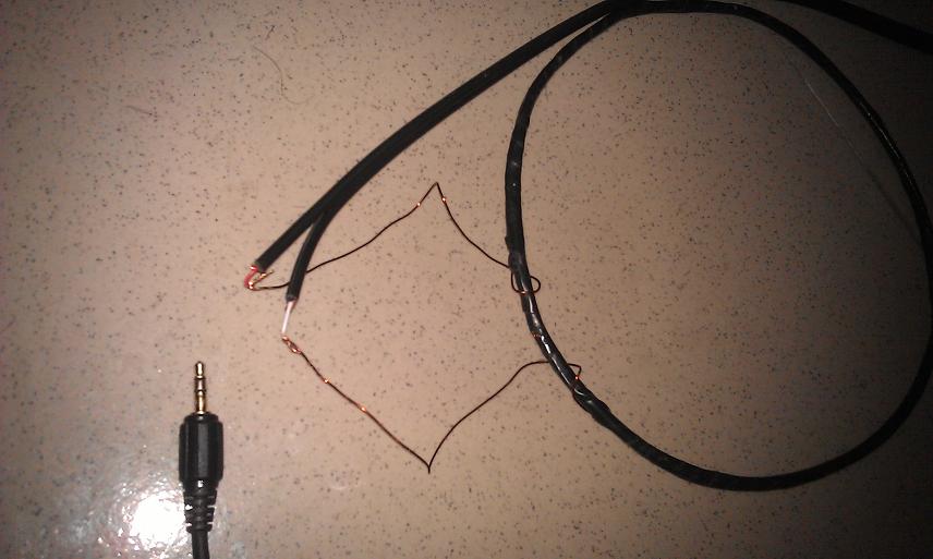

                          the coil with audio line(audio line has Shield), but coil haven't shield yet, I'm finding aluminum foil now...
