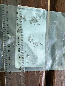

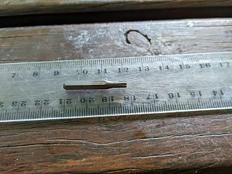

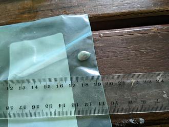

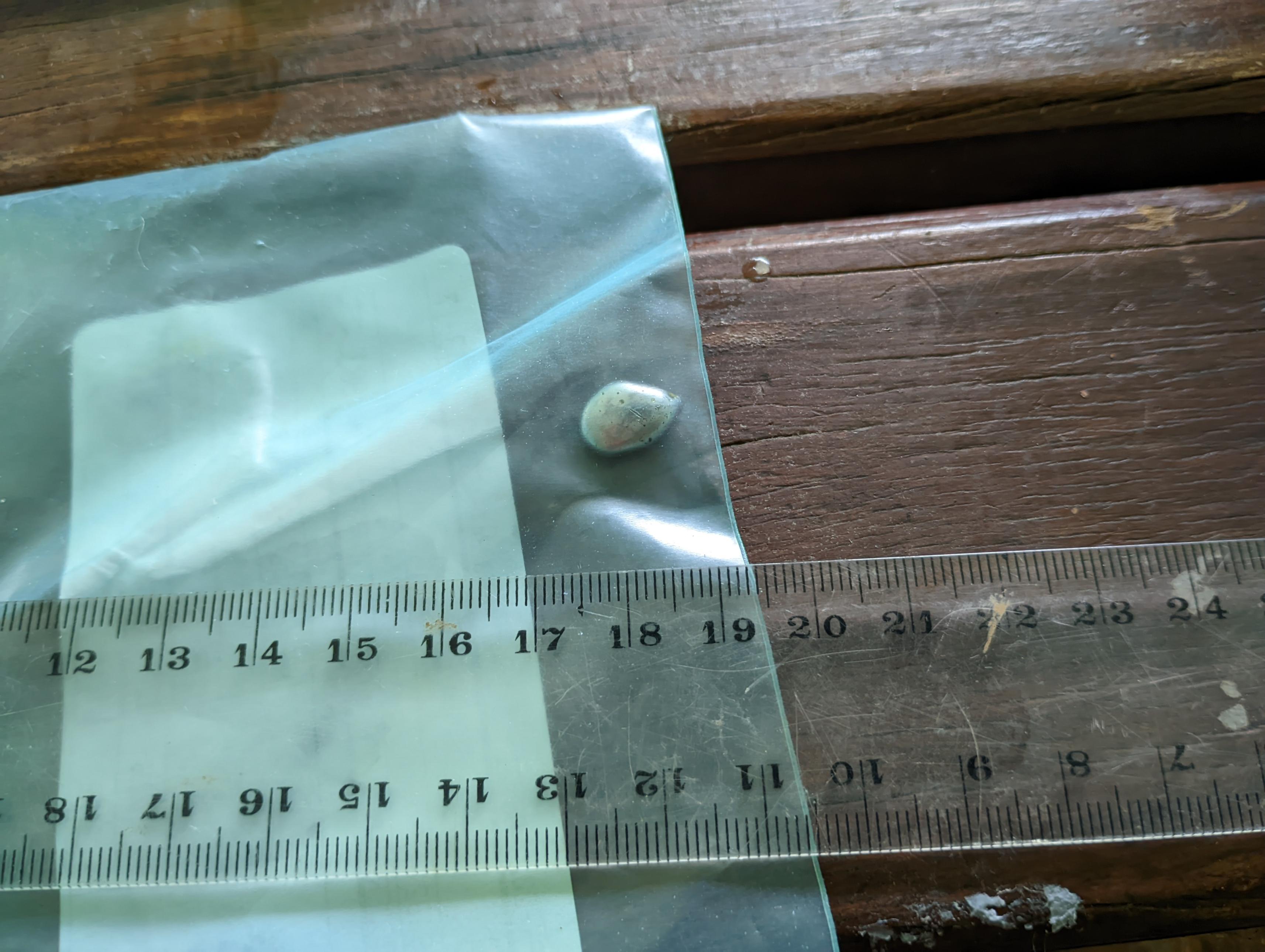

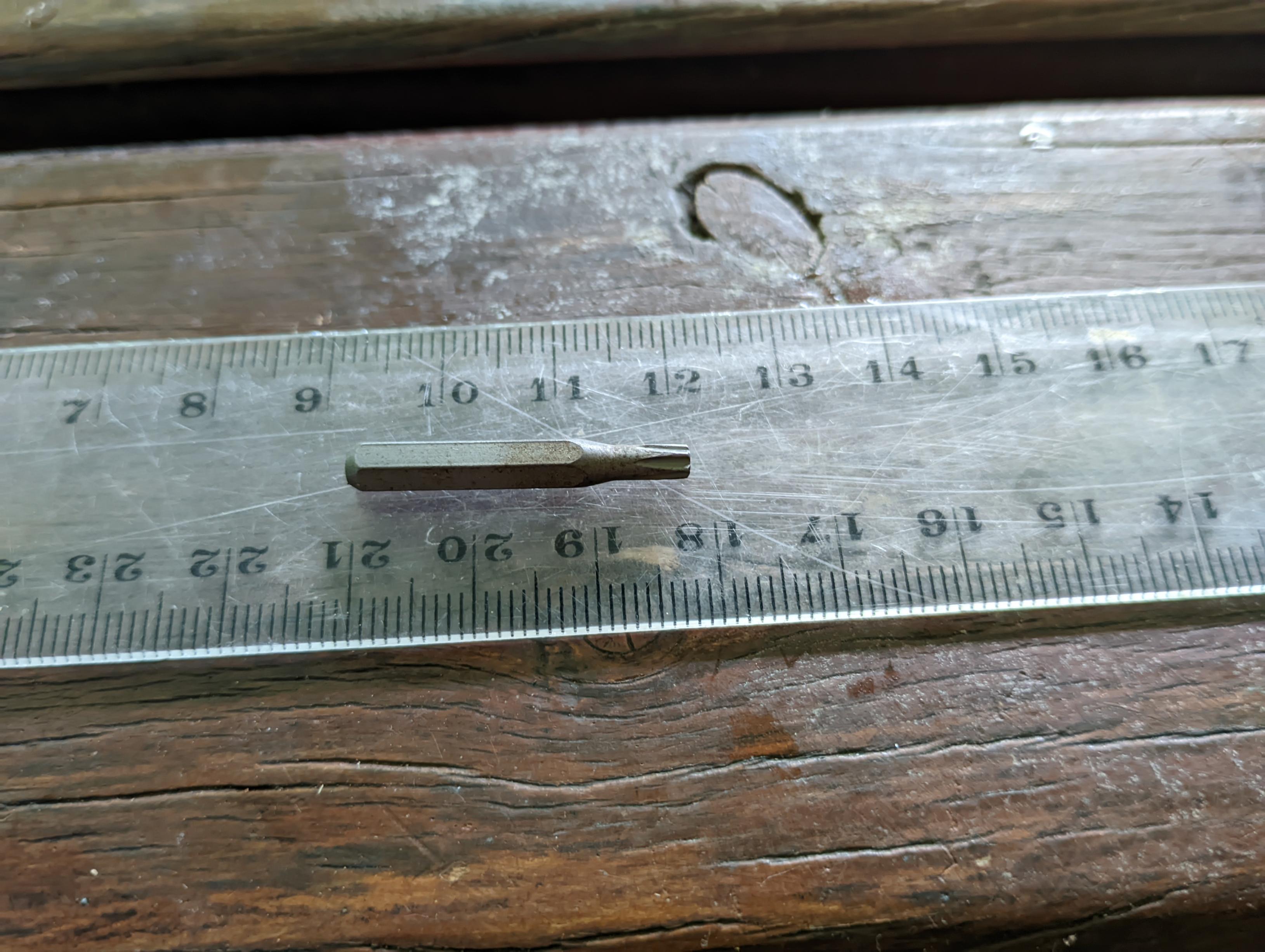

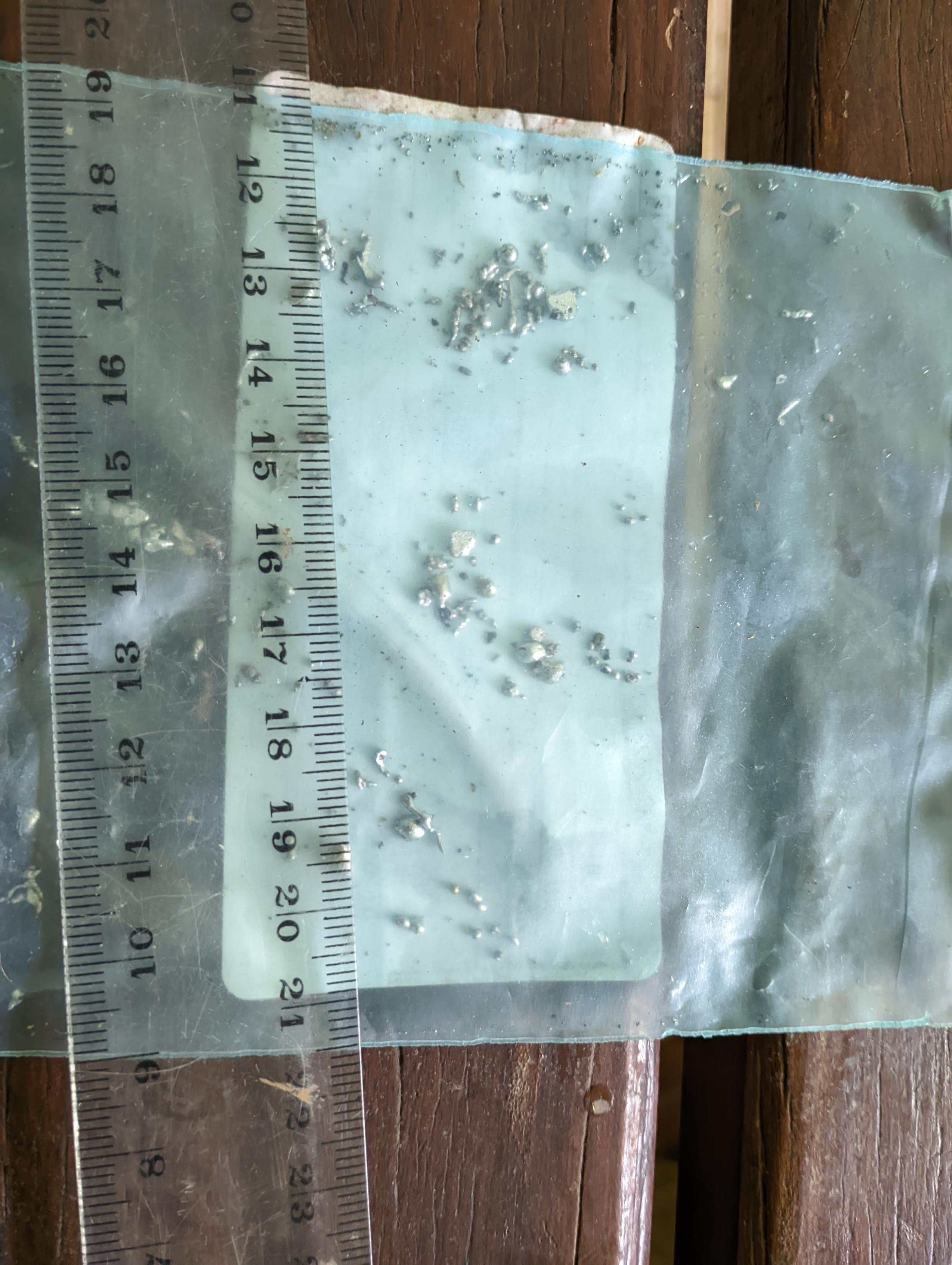

                Targets are blobs of solder (60/40)
                The ground is a sticky wet brown clay from coastal far north Queensland. I'm having trouble separating it from the signal of small nuggets.

                I've plotted the change in response for a number of targets below.
                x axis is uS since TX stop,
                y axis is byte values in scope memory equivalent to about 80mv per unit
                Left y axis is change in signal, Right y axis is waveform values
                Some response values are scaled to keep the peaks at the same height
                Click image for larger version  Name:	outside_50_2.jpg Views:	0 Size:	951.5 KB ID:	411814Click image for larger version  Name:	outside_50_2_zoom.jpg Views:	0 Size:	979.2 KB ID:	411813
                samples where placed directly on the coil to maximize signal.
                Click image for larger version  Name:	PXL_20230425_111805672 - Copy.jpg Views:	0 Size:	587.8 KB ID:	411815 Click image for larger version  Name:	PXL_20230425_111820519 - Copy.jpg Views:	0 Size:	596.1 KB ID:	411816 Click image for larger version  Name:	PXL_20230425_111829629 - Copy.jpg Views:	0 Size:	623.6 KB ID:	411817 Click image for larger version  Name:	PXL_20230425_112326669 - Copy.jpg Views:	0 Size:	632.2 KB ID:	411818
